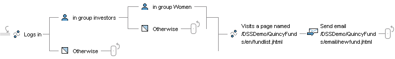

The following example shows an Otherwise element:
This diagram described in surrounding text
Here, the two Otherwise elements are followed by Stop elements. The effect is as follows: people who log in but are not in the profile group Investors are removed from the scenario. People who are in the group Investors but not in the group Women are also excluded from the scenario.

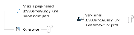

Note that Otherwise elements are designed to work only in conjunction with Condition or People elements. Do not use them on the branch of a fork whose other branches start with Event elements. In the example above, you could not do the following:
This use of an Otherwise element is invalid. If site visitors reach this stage in the scenario, the system will keep waiting for them to visit the specified page for as long as the scenario is active. It will not apply the Otherwise element to them if, for example, they visit a different page or log out of the site.
