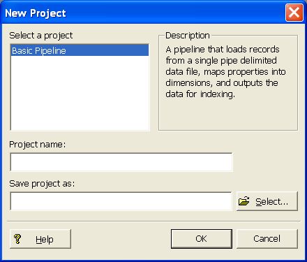

When creating a new project using the Oracle Commerce Developer Studio, you are prompted with the following dialog box:
To create a new project:
In order for a new pipeline to be run properly within the deployment template, the following must be properly specified:

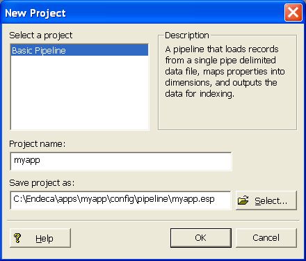

The Project Name field must be the same as the data prefix specified for the "
app
" element in<app dir>/config/script/AppConfig.xml
. By default, this data prefix will have been set to the name of the application that was specified when runningdeploy.bat
ordeploy.sh
.Recall that the
[appname]
specified was also used to create the base<app dir>
directory. For example, if "myapp
" was supplied as the[appname]
, and "c:\Endeca\apps
" was supplied as the Deployment Directory, then<app dir>
would bec:\Endeca\apps\myapp
. In this example, the Project Name should also be specified as "myapp
The Save Project As field should be
<app dir>\config\pipeline\[appname].esp
In the example above, the Save Project As field would be
c:\Endeca\apps\myapp\config\pipeline\myapp.esp
