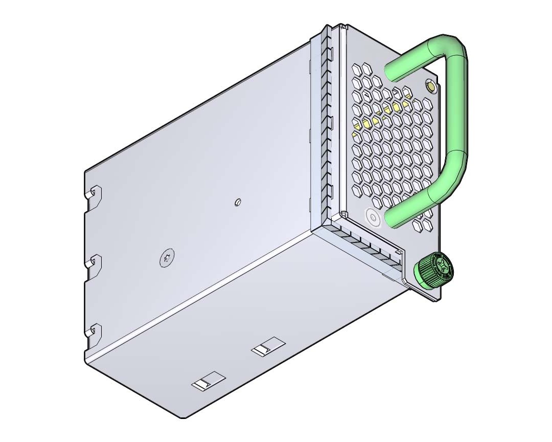

Inspect the Fan Hardware
  1. Unwrap the replacement fan from its antistatic packaging.
  2. Verify that there is no visible damage to the fan chassis.
  3. Verify that the internal door will open and close as the fan is turned upside -down and rightside-up.
    Illustration shows a fan being inspected.
  4. Verify that the thumbscrew spins freely and smoothly.
  5. Inspect the fan connector.
    See Inspect the Fan Connector.
