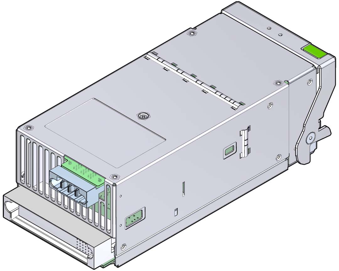

Inspect the Power Supply Hardware
  1. Unwrap the replacement power supply from its antistatic packaging.
  2. Verify that there is no visible damage to the power supply chassis.
    Illustration shows a power supply being inspected.
  3. Verify that the release button unsecures the release handle and permits the handle to snap closed.
  4. Verify that the release handle moves freely and smoothly.
  5. Inspect the power supply connectors.
    See Inspect the Power Supply Connectors.
