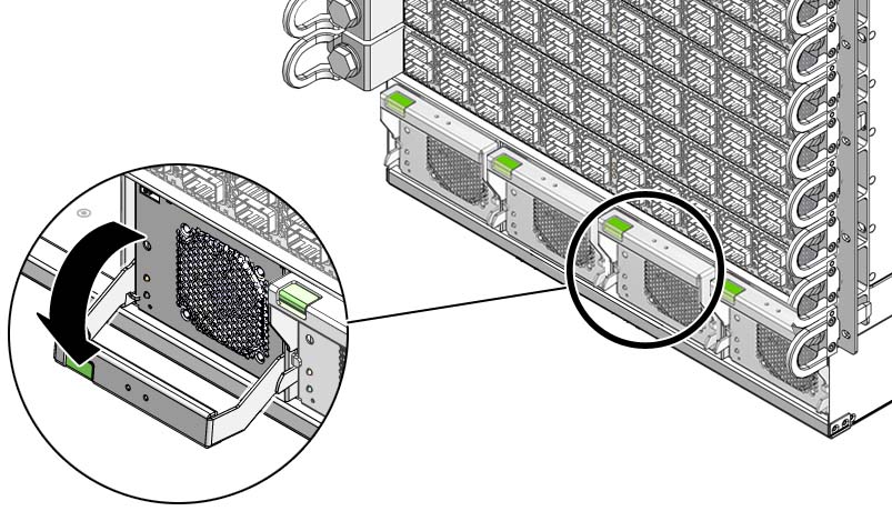

  3. Press the button and pull the release handle of the power supply down.
    Illustration shows a power supply being released.

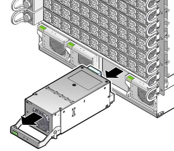

  4. Continue to pull the release handle of the power supply to remove it from the chassis.
    Illustration shows a power supply being removed.
