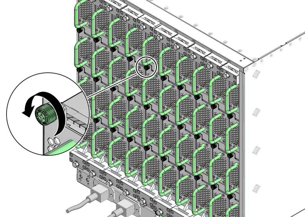

  3. Loosen the captive thumbscrew at the top of the fan.
    Illustration shows a fan being released.

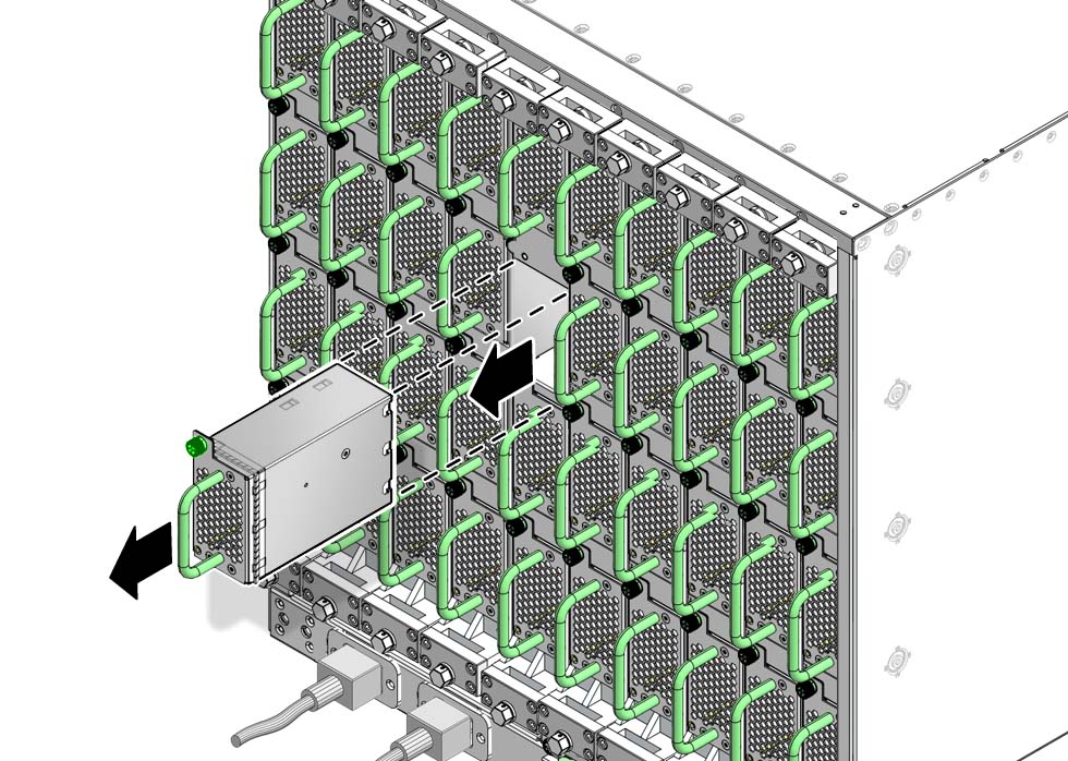

  4. Grasp the handle and pull the fan straight out.
    Illustration shows a fan being removed.
