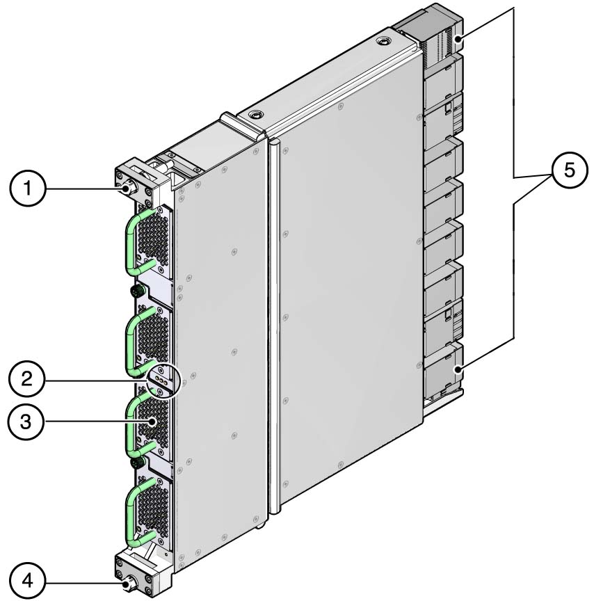

Fabric Card Identification
The following illustration identifies the various features of a fabric card.
Figure 8 Fabric Card Features
Illustration shows the features of a fabric card or fabric card filler.
Figure Legend
1 Upper retainer bolt
2 Status LEDs
3 Fans
4 Lower retainer bolt
5 XBOW connectors
