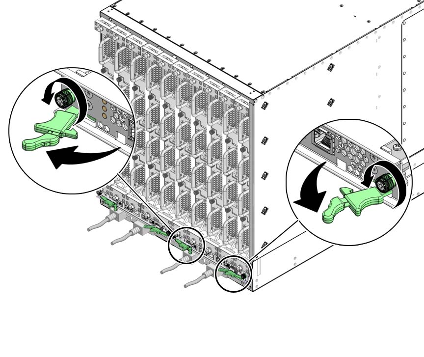

Remove a CMC
  1. Identify the prerequisite and subsequent tasks you must perform in conjunction with this procedure, to achieve a goal.
    See the table in Servicing the CMCs.
  2. Remove any cables connected to the CMC front panel.
  3. Loosen the two thumbscrews above the release levers.
  4. Squeeze the latches on the release levers and wait for the blue Ready-to-Remove LED to light.
  5. Swing the release levers outward.
    Illustration shows a CMC being released.
  6. Slowly pull the CMC from the chassis.
    Illustration shows a CMC being removed.
  7. Set the CMC aside.
  8. Install a replacement CMC.
    See Install a CMC.
