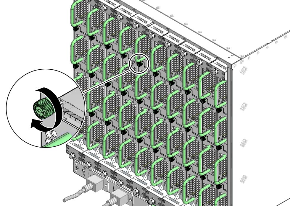

Note - Fans are hot-swappable and can be inserted into live fabric cards.
See the table in Servicing the Fans.
See Inspecting the Fans.
The fan might immediately power on.
For example, to check the fans in fabric card 0:
# checkfans |grep ‘FC 0’ Checking M9 fans... FC 0 Fan 0 RPM = 24356.000000 FC 0 Fan 1 RPM = 24356.000000 FC 0 Fan 2 RPM = 24070.000000 FC 0 Fan 3 RPM = 24356.000000 #
Note - Use the table in Component Addressing to determine the slot number or IPMB address of your component.
Switch Reference, checkfans command
