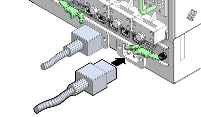

  2. Reconnect the power cord to the respective receptacle at the rear of the chassis.
    Illustration shows a power cord being installed.
    The Connected LED lights to indicate the power supply is connected to facility power.
