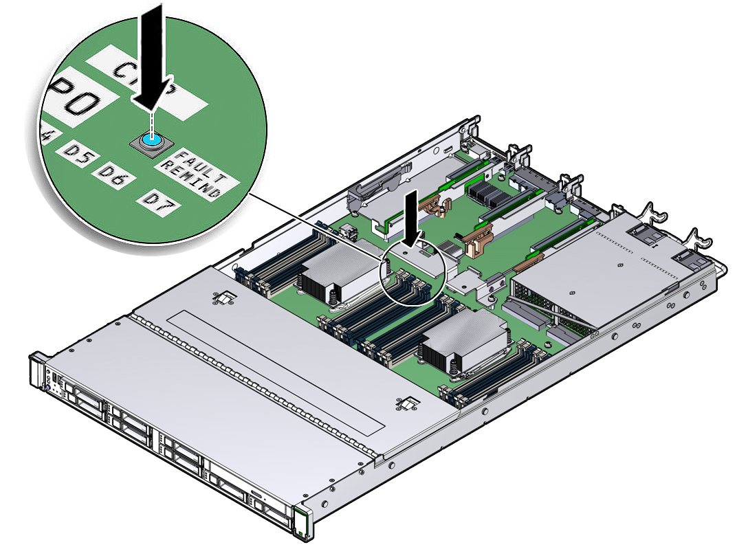

When the Fault Remind button is pressed, an LED located next to the Fault Remind button lights green to indicate that there is sufficient voltage present in the fault remind circuit to light any fault LEDs that were lit due to a component failure. If this LED does not light when you press the Fault Remind button, it is likely that the capacitor powering the fault remind circuit has lost its charge. This can happen if the Fault Remind button is pressed for several minutes with fault LEDs lit or if power has been removed from the controller for more than 15 minutes.
The following figure shows the location of the Fault Remind button.
Figure 8  Fault Remind Button Location
image:Figure showing the location of the Fault Remind button.
