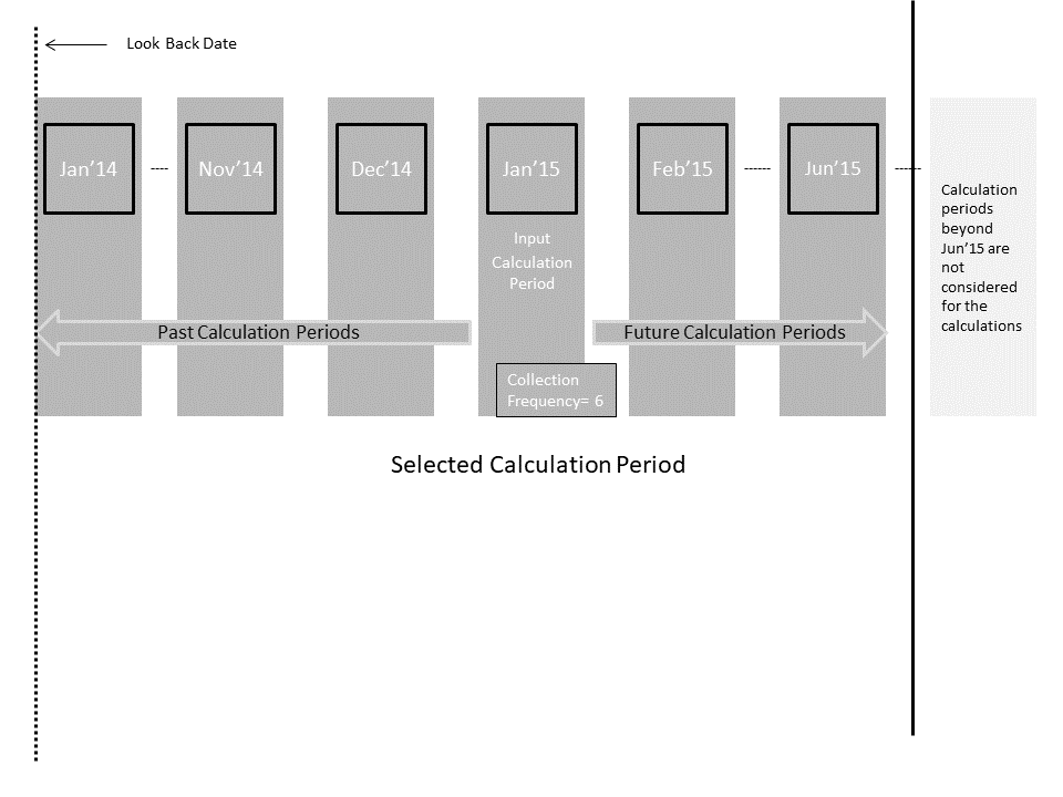

The system selects the calculation periods as mentioned in the image below:
![Identify Periods Scenario F](_images/identify-periods-scenario-f.png)
First, the system identifies that the input calculation period Jan'15 consists of three calculation period segments:

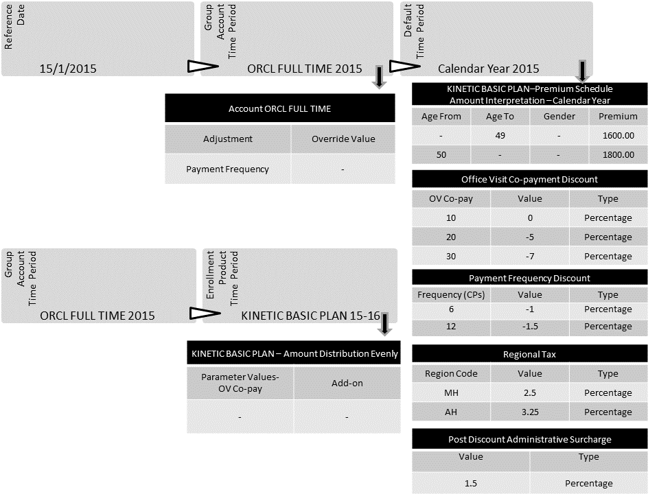

Calculations for KINETIC BASIC PLAN Jan'15
The image below specifies the configuration that is applicable for the last segment within the calculation period Jan'15: Contract Period 2 / Account ORCL FULL TIME / KINETIC BASIC PLAN
![Configuration Settings Scenario F KINETIC BASIC Plan](_images/configuration-settings-scenario-f-kinetic-basic-plan.png)
Enrollment product premium
The person’s age is still 28 years, therefore the applicable premium value is 1600. This is the value for a calendar year. The system considers 1600.00 as the applicable value for a period of 365 days starting from first day of the contract period. The calendar period is considered to be of 365 days because the calendar year (2015) of the reference date has 365 days but since the policy enrollment product starts after the contract period, policy enrollment product start date is considered hence the premium is calculated only for 361 days.
This segment is identified as a partial enrollment within the calculation period. The amount charged for the calculation period segment is Daily Amount * # Actual Enrolled Days.
