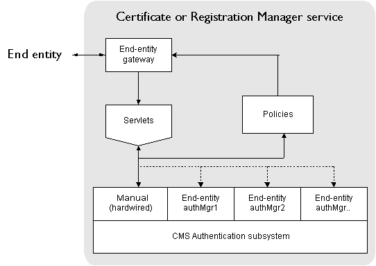

Authentication Subsystem Architecture
The authentication subsystem of Certificate Management System permits a flexible number of authentication managers for end-entity authentication. This architecture is illustrated in Figure 13.1. An authentication manager (authMgr) is a configured instance of an authentication plug-in implementation.
Figure 13.1 Authentication subsystem architecture
Table 13.1 describes the components shown in Figure 13.1.
Table 13.1 Description of components
Component
Description
End entity
Specifies end entities, such as users, servers, virtual private network (VPN) clients, or routers enrolling for a certificate through a web-based form.
End-entity gateway
Specifies the end-entity gateway provided by Certificate Management System.
Servlets
Specifies end-entity servlets. Each type of request from an end entity is handled by a different servlet; each servlet serves the correct HTML form or other information to the end entity, depending on the protocols supported by that entity.
Policies
Specifies currently configured policies for a Certificate Manager or Registration Manager (depending on which subsystem is processing end-entity requests).
Manual
Specifies manual authentication. If you do not configure Certificate Management System to use any of the authentication plug-in modules listed in the Authentication Registration Plugin tab, the server uses manual authentication for end-entity enrollment. This means that all end-entity enrollment requests are queued for agent approval.
End-entity authMgr
Specifies configured authentication managers (based on authentication plug-ins provided out of the box and custom, if any) for authenticating end entities.
How the Architecture Works
The setup shown in Figure 13.1 works in the following way:

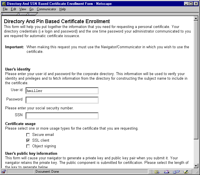

  1. An end entity enrolls for a certificate through a web-based form that includes fields in which the end entity enters the required enrollment credentials or provides authentication parameter values. The form has been customized to use a specific authentication manager.
  2. On the CMS side, a servlet receives the following as input from the form the end entity used:
  3. The servlet then calls the appropriate authentication manager instance to authenticate the end entity.
  4. After the end entity is authenticated, policies are applied on the request by either a Certificate Manager or Registration Manager, depending on which subsystem is processing the request.
  5. Finally, a certificate is issued and returned to the end entity.

Figure 13.2 shows a directory-based authentication form customized to use a social security number (SSN) for authentication in addition to user ID and password for the authentication directory. Note the text field named SSN.
Figure 13.2 End-entity enrollment form for SSN and directory-based authentication
