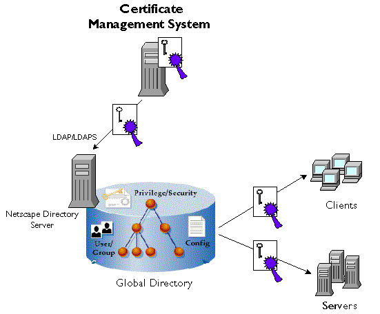

Large corporations typically use Lightweight Directory Access Protocol (LDAP) directories, such as Netscape Directory Server, to store and manage corporatewide data, including user and group information and network resource data. If you have deployed an LDAP-compliant directory, you can configure the Certificate Manager to automatically publish your CA and end-entity certificate-related information to that directory. For example, if you have configured the Certificate Management System to employ directory-based authentication, you should consider publishing the CA and end-entity certificates to the same directory. This way, you can keep your users' security credentials with the rest of the user information (see Figure 20.1).
Figure 20.1 Publishing certificates to a directory for distribution
The ability of a Certificate Manager to publish certificates, CRLs, and other certificate-related objects to a directory using the LDAP or LDAPS protocol is called LDAP publishing and the directory to which it publishes is called the publishing directory. Note that configuring the Certificate Manager for LDAP publishing is optional--you can turn this feature off without affecting any of the certificate issuance, renewal, and revocation operations handled by the server.

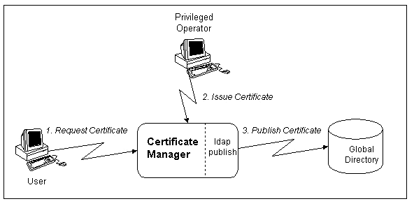

You can configure the Certificate Manager to automatically publish certificates to the directory every time a certificate is issued and at a predetermined interval--for example, every day or once every week. Privileged users (administrators and agents) can also manually initiate the LDAP publishing process.
Figure 20.2 illustrates LDAP publishing by the Certificate Manager when a certificate requested via the manual-enrollment process is issued.
Figure 20.2 Publishing by a Certificate Manager
