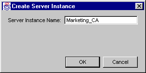

  3. From the Object menu, choose the Create Instance Of option and, in the pop-up menu that appears, choose Certificate Management System.
  4. As shown in this figure, you can also right-click to choose this option from the pop-up menu.
    The Create Server Instance dialog box appears.
  5. Type a name for the instance. For the name, you can use any combination of letters (aA to zZ), digits (0 to 9), an underscore (_), and a hyphen (-); other characters and spaces are not allowed. For example, you can type Netscape_root-CA as the instance name, but not Netscape root CA.
  6. Click OK.

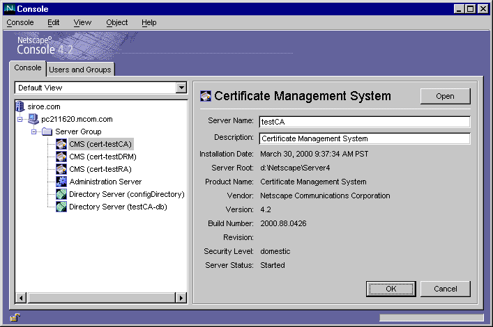

To change the name of a particular CMS instance:
  1. Log in to Netscape Console (see "Logging In to Netscape Console").
  2. In the Console tab, select the CMS instance you want to rename.
  3. Click Edit.
  4. Details about the selected CMS instance appear in the right pane.
  5. Specify the appropriate information:
  6. Server Name. Type a descriptive name for the server.
    Description. Type any additional description for the server. For example, you may want to type information that will help you identify this instance of Certificate Management System.
  7. Click OK.
  8. You are returned to the previous screen. The new name appears in the right pane.

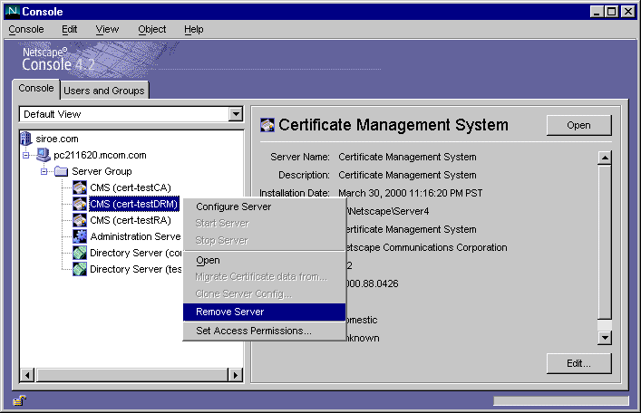

  2. In the Console tab, select the CMS instance you want to remove.
  3. From the Object menu, choose Stop; you can also right-click to choose this option from the pop-up menu (see the figure below).
  4. When the server has stopped, from the Object menu, choose Remove Server.
  5. As shown in the figure below, you can also right-click to choose this option from the pop-up menu.
  6. When prompted, confirm that you want to remove the server instance.
  7. The selected CMS instance is removed. The corresponding internal database is not removed. If you want to remove it, select the instance, and repeat steps 3 through 5.

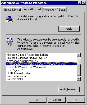

Uninstalling by Using the Windows NT Add/Remove Programs Utility
To remove Certificate Management System by using the Windows NT Add/Remove Programs utility:
  1. From the Start menu, choose Settings, then Control Panel.
  2. In the Control Panel, choose Add/Remove Programs.

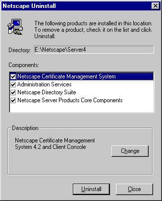

  3. In the Add/Remove Programs Properties window, choose Netscape Server Products 4.2 <server_root>, and click Add/Remove.
  4. In the Netscape Server Uninstall window, make sure all the components are selected, and click Uninstall.
  5. The uninstallation program starts.
