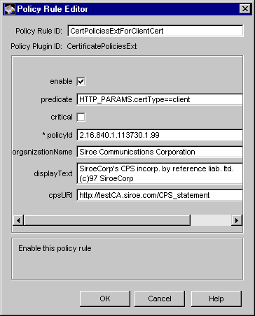

Certificate Policies Extension Policy |
The CertificatePoliciesExt plug-in module implements the certificate policies extension policy. This policy enables you to configure Certificate Management System to add the Certificate Policies Extension defined in X.509 and PKIX standard RFC 2459 (see http://www.ietf.org/rfc/rfc2459.txt) in certificates. The extension contains a sequence of one or more policy statements, each indicating the policy under which the certificate has been issued and identifying the purposes for which the certificate may be used. Presence of this extension in certificates enables an application with specific policy requirements to compare its list of policies to the ones contained in a certificate during its validation; typically, such applications will have a list of policies (which they will accept) and compare the policies in the certificate to their list as a part validating the certificate.
To promote interoperatability, the PKIX standard recommends that the policy statements or information terms should be included in certificates in the form of object identifiers (OIDs). For more information on OIDs, see "Object Identifier". This means, in order for the server to add this extension to any certificate it issues, you need to compose policy statements you want to include in the extension, define OIDs for these policy statements, and configure the server with these OIDs.
When determining whether to add this extension to certificates, keep in mind that if the extension exists in a certificate and if it is marked critical, the application validating the certificate must be able to interpret the extension (including the optional qualifiers, if any), or else it must reject the certificate. For general guidelines on setting the certificate policies extension, see "certificatePolicies" in Appendix B of Netscape Certificate Management System Installation and Deployment Guide.
The certificate policies extension policy in Certificate Management System enables you to set the extension with the following information:
During installation, Certificate Management System automatically creates an instance of the certificate policies extension policy. See "CertificatePoliciesExt Rule".
CertificatePoliciesExt Module
The Java class that implements the certificate policies extension policy is as follows:
com.netscape.certsrv.policy.CertificatePoliciesExt
Figure 18.5 shows how the configurable parameters for the CertificatePoliciesExt module are displayed in the CMS window.
Figure 18.5 Parameters defined in the CertificatePoliciesExt module
The configuration shown in Figure 18.5 creates a policy rule named CertPoliciesExtForClientCert, which enforces a rule that the server should set the certificate policies extension in all client certificates.
Table 18.5 gives details about each of these parameters.
The policy rule named CertificatePoliciesExt is an instance of the CertificatePoliciesExt module. Certificate Management System automatically creates this rule during installation. By default, the rule is configured as follows:
For details on individual parameters defined in the rule, see Table 18.5. You need to review this rule and make the changes appropriate for your PKI setup. For instructions, see "Step 2. Modify Existing Policy Rules". Also, if you need to add additional instances, follow the instructions in "Step 4. Add New Policy Rules". For example, if you want to include different policy statements in different types of certificates, you should create multiple instances of the policy module and configure each instance with the appropriate policy OID and predicate expression.

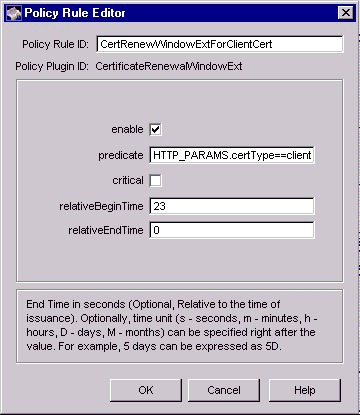

Certificate Renewal Window Extension Policy |
The CertificateRenewalWindowExt plug-in module implements the certificate renewal window extension policy. This policy enables you to configure Certificate Management System to add the Certificate Renewal Window Extension to certificates. The extension, which must be noncritical, aids in managing the life cycle of a certificate by specifying a process to follow for renewing a certificate and by defining a time window when automatic renewal of the certificate should be attempted.
Every certificate issued by Certificate Management System has a validity period beyond which it cannot be used. In order to continue to participate in the PKI-using system beyond this validity period, the entity owning the certificate must renew the certificate. Renewal of a certificate essentially means getting a new certificate for the existing key pair with a new validity time period (and updated attributes).
Once a certificate is issued, the owner of the certificate may attempt its renewal any time. To prevent certificate owners from renewing their certificates too often and thus reduce the overhead of processing new certificate requests, the CA can use a policy that restricts the time period when certificate renewal may occur. For example, the CA can use a policy that limits the renewal process to the last few weeks or days of validity of the certificate, thus defining a certificate renewal window. In general, the renewal window must be sufficient for the renewal to occur, but at the same time delay the renewal as long as possible to best utilize a certificate's life time.
The certificate-renewal process is often different than the enrollment process an entity uses to obtain the certificate; this is because the entity already owns a key pair that is associated with his or her identity. For example, in Certificate Management System, the certificate-renewal process for end users is different than the enrollment process they used to obtain the certificate. To renew their certificates, end users go to the certificate-renewal interface of Certificate Management System and submit their original certificates; for details, see "Authentication of End Users During Certificate Renewal".
Because the renewal process requires end users to remember when their certificates expire and renew them before the expiry date, some clients provide built-in support for automated renewal. Inclusion of the certificate renewal window extension in certificates is useful in a PKI setup with such clients; such a setup eliminates the need for the owner of the certificate to manually submit a renewal request to the CA and install the renewed certificate. For example, assume you have deployed clients that can automatically submit certificate-renewal requests to Certificate Management System. If you issue certificates with the certificate renewal window extension to these clients, they can then read this extension for the renewal window and automatically get the certificate renewed from the CA during that window.
For a PKI setup without clients that can handle automated certificate renewals, Certificate Management System enables administrators to easily manage certificate renewals using the following features:
Unlike some of the other policy modules, Certificate Management System does not create an instance of the certificate renewal window extension policy during installation. If you want the server to add this extension to certificates, you must create an instance of the CertificateScopeOfUseExt module and configure it (see "Step 4. Add New Policy Rules").
CertificateRenewalWindowExt Module
The Java class that implements the certificate renewal window extension policy is as follows:
com.netscape.certsrv.policy.CertificateRenewalWindowExt
Figure 18.6 shows how the configurable parameters for the CertificateRenewalWindowExt module are displayed in the CMS window.
Figure 18.6 Parameters defined in the CertificateRenewalWindowExt module
The configuration shown in Figure 18.6 creates a policy rule named CertRenewWindowExtForClientCert, which enforces a rule that the server should set the certificate renewal window extension in client certificates only; the renewal window starts 30 days before a certificate expires and ends with certificate expiration.
Table 18.6 gives details about each of these parameters.

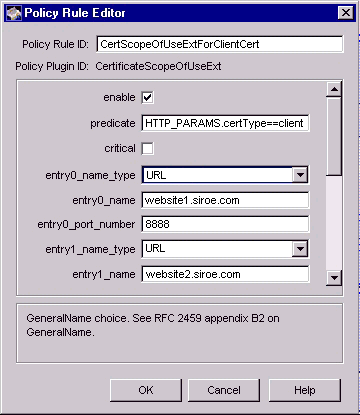

Certificate Scope of Use Extension Policy |
The CertificateScopeOfUseExt plug-in module implements the certificate scope of use extension policy. This policy enables you to configure Certificate Management System to add the Certificate Scope of Use Extension to certificates. The extension enables you to specify a list of web sites that may request the use of a particular certificate for SSL client authentication, thus aiding certificate-using applications to select certificates to present to web sites and to control release of these certificates.
The SSL protocol provides a way for a client application to authenticate itself to a web site or server. SSL client authentication occurs upon request of the server, and proceeds by providing a certificate and a signature to the server. The client may have more than one certificate that could be used to perform this authentication. The SSL protocol provides a way for the server to indicate which certificate may be useful by listing issuing CAs in one of the SSL protocol messages.
By using a particular certificate for SSL client authentication, the client releases information about itself to the server. This information may include the name and key information contained in the certificate. It also releases the information that the client holds a certificate from a particular CA. This information may be of interest to the company running the server, for example to find users that have certificates from competing companies.
The certificate scope of use extension can be included in certificates to restrict the scope-of-use of the certificate for client authentication; the extension enables the certificate-using application to restrict the release of individual certificates to web sites requesting SSL client authentication.
The certificate scope of use extension policy in Certificate Management System enables you to include a list of name patterns that will match server DNS names where the certificate may be used. It's up to the certificate-using applications to use the values in this extension to filter the list of potential certificates to use for client authentication.
Unlike some of the other policy modules, Certificate Management System does not create an instance of the certificate scope of use extension policy during installation. If you want the server to add this extension to certificates, you must create an instance of the CertificateScopeOfUseExt module and configure it (see "Step 4. Add New Policy Rules").
CertificateScopeOfUseExt Module
The Java class that implements the certificate scope of use extension policy is as follows:
com.netscape.certsrv.policy.CertificateScopeOfUseExt
Figure 18.7 shows how the configurable parameters for the CertificateScopeOfUseExt module are displayed in the CMS window.
Figure 18.7 Parameters defined in the CertificateScopeOfUseExt module
The configuration shown in Figure 18.7 creates a policy rule named CertScopeOfUseExtForClientCert, which enforces a rule that the server should set the certificate scope of use extension in client certificates only.
Table 18.7 gives details about each of these parameters.

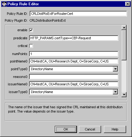

Figure 18.8 shows how the configurable parameters for the CRLDistributionPointsExt module are displayed in the CMS window.
Figure 18.8 Description of parameters defined in the CRLDistributionPointsExt module
The configuration shown in Figure 18.8 creates a policy rule named CRLDistPtsExtForRouterCert, which enforces a rule that the server should set the CRL distribution point extension in router certificates; the CRL location is a X.500 directory.
Table 18.8 gives details about each of these parameters.

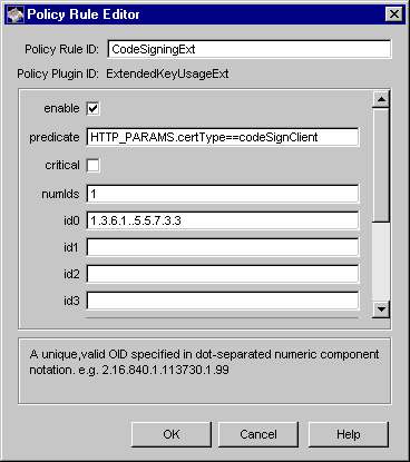

Figure 18.9 shows how the configurable parameters for the ExtendedKeyUsageExt module are displayed in the CMS window.
Figure 18.9 Parameters defined in the ExtendedKeyUsageExt module
The configuration shown in Figure 18.9 creates a policy rule named CodeSigningExt, which enforces a rule that the extended key usage extension should be set in object-signing certificates.
Table 18.10 gives details about each of these parameters.
CODESigningExt Rule
The rule named CODESigningExt is an instance of the ExtendedKeyUsageExt module. Certificate Management System automatically creates this rule during installation. By default, the rule is configured as follows:
Note that this policy rule must remain enabled if you want Certificate Management System to issue object signing certificates with the correct extended key usage extension.
For details on individual parameters defined in the rule, see Table 18.10. You need to review this rule and make the changes appropriate for your PKI setup. For instructions, see "Step 2. Modify Existing Policy Rules". For instructions on adding additional instances, see "Step 4. Add New Policy Rules".

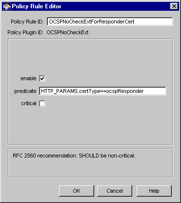

OCSPSigningExt Rule
The rule named OCSPSigningExt is an instance of the ExtendedKeyUsageExt module. Certificate Management System automatically creates this rule during installation. By default, the rule is configured as follows:
Note that this policy rule must remain enabled if your PKI setup includes a CA-delegated OCSP responder and you want to issue an OCSP responder certificate to that server; the rule adds the extended key usage extension to an OCSP responder certificate indicating that the associated key can be used for signing OCSP responses.
Here's some background information that will help you understand why you should set this extension in OCSP responder certificates:
The online certificate status protocol (OCSP) enables OCSP-compliant applications to determine the revocation status of a certificate being validated. Certificate Management System supports the OCSP service--you can configure a Certificate Manager to publish CRLs to an online validation authority (also called OCSP responder); for details, see "Publishing of CRLs to an Online Validation Authority". If you configure Certificate Management System to work with an OCSP responder, OCSP-compliant applications in your PKI setup will be able to do real-time verification of certificates by querying the OCSP responder for their revocation status. Note that these applications will be able to query the OCSP responder only if the certificate being validated includes the authority information access extension indicating the location of the OCSP responder; for information on adding this extension to certificates, see "Authority Information Access Extension Policy".
When queried by an application on the status of a certificate, the OCSP responder sends a digitally signed response. To generate the signature, the responder needs to use a key. Because the signature needs to be verified by the application that sought the response, RFC 2560 recommends that the key used for signing an OCSP response must belong to one of the following:
If you want to deploy a CA-delegated OCSP responder, the OCSPSigningExt rule enables you to add the extended key usage extension (with OCSPSigning value) to the OCSP responder certificate. In addition to this extension, the responder's signing certificate should also include the OCSP no check extension. For details, see "OCSP No Check Extension Policy".

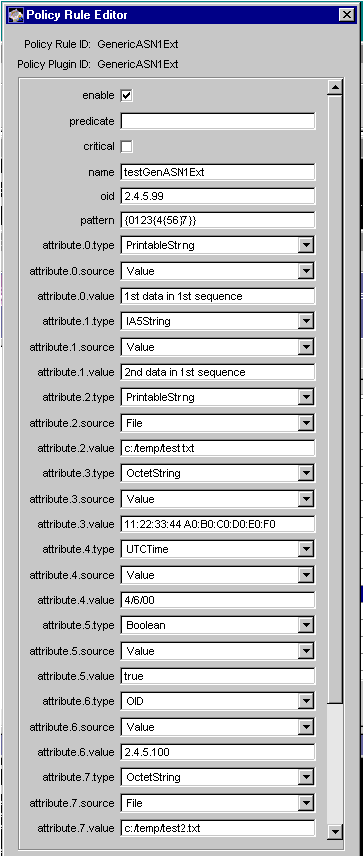

Figure 18.10 shows how the configurable parameters for the GenericASN1Ext module are displayed in the CMS window.
Figure 18.10 Parameters defined in the GenericASN1Ext module
The configuration shown in Figure 18.10 defines a custom extension named testGenASN1Ext with OID 2.4.5.99. The extension is non-critical, and it will be added to all certificates issued by the server. The expected dumpasn1 output (see "dumpasn1 Tool") of the resulting extension, would look like this:

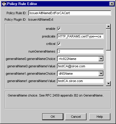

Figure 18.11 shows how the configurable parameters for the IssuerAltNameExt module are displayed in the CMS window.
Figure 18.11 Parameters defined in the IssuerAltNameExt module
The configuration shown in Figure 18.11 creates a policy rule named IssuerAltNameExtForCACert, which enforces a rule that the server should set the issuer alternative name extension in CA certificates only.
Table 18.12 gives details about each of these parameters.

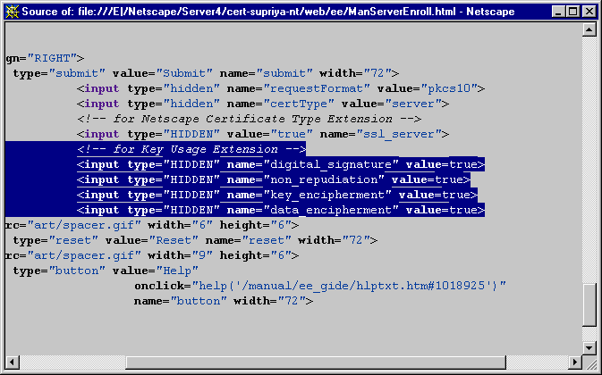

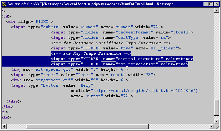

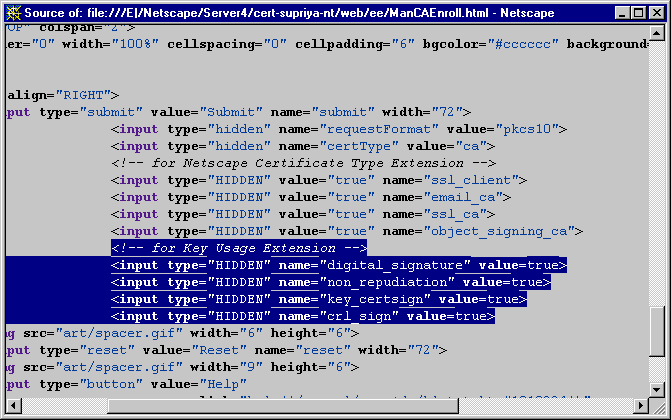

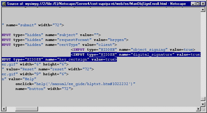

Additionally, as you'll notice in Figure 18.13 through Figure 18.17, the default enrollment forms provided for requesting various types of certificates (see "Forms for Certificate Enrollment") include the appropriate HTTP input variables that correspond to the key-usage bits. By default only variables that correspond to key-usage bits that need to be set are included in the form.
Typically, you won't have to change the key-usage bit setting by editing the enrollment forms as you can do this easily by making the appropriate changes to the policy instance (bits set on the server side override the ones set on the client side). However, if you want to add new variables on the client side, you can do that too. Be sure to add the new variable in the following format:
<input type="HIDDEN" name="variable_name" value=true>
where, variable_name can be any of the HTTP input variables listed in Table 18.14.
The value of an HTTP input variable corresponding to a key-usage bit must be either true or false; any other value is considered equivalent to false. For example, a value tree would be interpreted as false by the server. Note that values true and false are case insensitive.

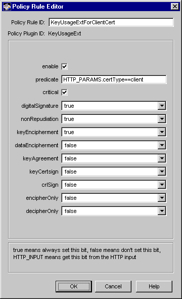

Figure 18.12 shows how the configurable parameters for the KeyUsageExt module are displayed in the CMS window.
Figure 18.12 Parameters defined in the KeyUsageExt module
The configuration shown in Figure 18.12 creates a policy rule named KeyUsageExtForClientCert, which enforces a rule that the server should set the key usage extension (digitalSignature, nonRepudiation, and keyEncipherment bits) in client certificates.
Table 18.15 gives details about each of these parameters.

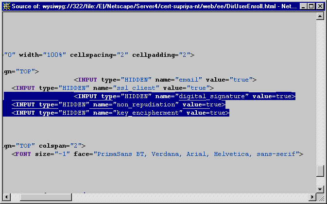

Notice that the key-usage bits specified in the default policy rule match the bits specified in the enrollment form for requesting SSL client certificates. Figure 18.16 shows the default directory-based enrollment form for end users with the information related to the key usage extension variables highlighted--it shows three of the total number of variables listed in Table 18.14. Note that by default three key-usage bits--digitalSignature, nonRepudiation, and keyEncipherment--are enabled and the remaining bits are disabled.
Additionally, also notice the HTTP variables for the Netscape certificate type extension: the values indicate that the certificate is meant for S/MIME and SSL client authentication use only. (For details on Netscape certificate type extension, see "Netscape Certificate Type Extension Policy".)
Figure 18.16 Key usage extension bits in the directory-based enrollment form
Keep in mind that for requesting client certificates, there are many enrollment forms. You may be using a combination of them:
For details about these forms, see "Enrollment Forms".
Each of these forms embed HTTP input variables (for key-usage bits) that are considered appropriate for the certificate being requested using that form. If you want, you may create additional instances of the key usage extension policy, one each for each client certificate enrollment form and configure these instances as appropriate. Be sure to use the correct predicate expression to distinguish the certificates to thus avoid setting incorrect bits.

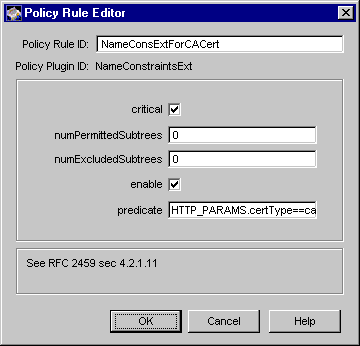

Figure 18.18 shows how the configurable parameters for the NameConstraintsExt module are displayed in the CMS window.
Figure 18.18 Parameters defined in the NameConstraintsExt module
The configuration shown in Figure 18.18 creates a policy rule named NameConsExtForCACert, which enforces a rule that the server should set the name constraints extension as a critical extension in CA certificates.
Table 18.16 gives details about each of these parameters.
NameConstraintsExt Rule
The policy rule named NameConstraintsExt is an instance of the NameConstraintsExt module. Certificate Management System automatically creates this rule during installation. By default, the rule is configured as follows:
For details on individual parameters defined in the rule, see Table 18.16. You need to review this rule and make the changes appropriate for your PKI setup. For instructions, see "Step 2. Modify Existing Policy Rules". For instructions on adding additional instances, see "Step 4. Add New Policy Rules".

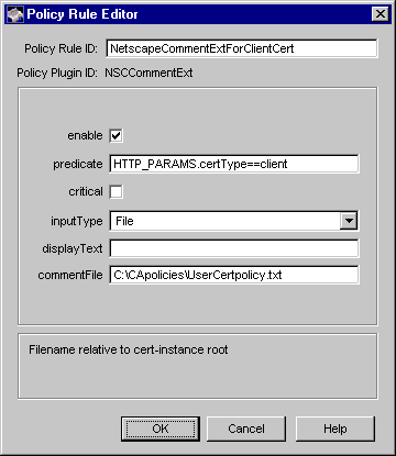

Figure 18.19 shows how the configurable parameters for the NSCCommentExt module are displayed in the CMS window.
Figure 18.19 Parameters defined in the NSCCommentExt module
The configuration shown in Figure 18.19 creates a policy rule named NetscapeCommentExtForClientCert, which enforces a rule that the server should set the Netscape certificate comment extension in client certificates.
Table 18.17 provides details for each of these parameters.
NSCCommentExt Rule
The policy rule named NSCCommentExt is an instance of the NSCCommentExt module. Certificate Management System automatically creates this rule during installation. By default, the rule is configured as follows:
For details on individual parameters defined in the rule, see Table 18.17. You need to review this rule and make the changes appropriate for your PKI setup. For instructions, see "Step 2. Modify Existing Policy Rules". For instructions on adding additional instances, see "Step 4. Add New Policy Rules".

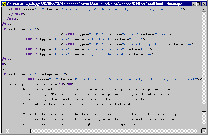

Additionally, the default enrollment forms--the directory-based, directory- and PIN-based, manual, Kerberos server-based, and NIS server-based enrollment forms--for various types of certificates also include the appropriate HTTP input variables corresponding to Netscape certificate type extension bits. For details about these forms, see "Forms for Certificate Enrollment".
Figure 18.20 shows the default directory-based enrollment form for end users with HTTP input variables specific to Netscape certificate type extension highlighted; it shows two of the total number of variables listed in Table 18.19, ssl_client and email, indicating that these bits be set in certificates requested using this form.
Figure 18.20 Netscape certificate type extension-specific variables in enrollment forms
Note that the default enrollment forms embed variables that are considered appropriate for the type of certificate, such as client, server, or CA, that can be requested using the form. For example, the server enrollment form embeds the ssl_server variable, whereas the subordinate CA (Certificate Manager) enrollment form embeds the ssl_client, email_ca, ssl_ca and object_signing_ca variables.
In general, the forms are set up so that you don't have to make any modifications. However, if there is a need to modify the bit settings, be sure to add or remove the corresponding variable. Also, when adding a new variable, make sure that the HTML input format is as follows:
<input type="HIDDEN" value="true" name="variable_name">
where variable_name can be any of the variables listed in Table 18.19.

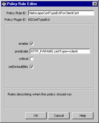

Figure 18.21 shows how the configurable parameters for the NSCertTypeExt module are displayed in the CMS window.
Figure 18.21 Parameters defined in the NSCertTypeExt module
The configuration shown in Figure 18.21 creates a policy rule named NetscapeCertTypeExtForClientCert, which enforces a rule that the server should set the Netscape certificate type extension in client certificates.
Table 18.20 gives details about each of these parameters.
NSCertTypeExt Rule
The policy rule named NSCertTypeExt is an instance of the NSCertTypeExt module. Certificate Management System automatically creates this rule during installation. By default, the rule is configured as follows:
For details on individual parameters defined in the rule, see Table 18.20. You need to review this rule and make the changes appropriate for your PKI setup. For instructions, see "Step 2. Modify Existing Policy Rules". For instructions on adding additional instances, see "Step 4. Add New Policy Rules".

Figure 18.22 shows how the configurable parameters for the OCSPNoCheckExt module are displayed in the CMS window.
Figure 18.22 Parameters defined in the OCSPNoCheckExt module
The configuration shown in Figure 18.22 creates a policy rule named OCSPNoCheckExtForResponderCert, which enforces a rule that the server should set the OCSP no check extension in OCSP responder certificates only.
Table 18.21 provides details for each of these parameters.

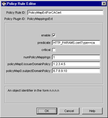

Policy Mappings Extension Policy |
The PolicyMappingsExt plug-in module implements the policy mappings extension policy. This policy enables you to configure Certificate Management System to add the Policy Mappings Extension defined in X.509 and PKIX standard RFC 2459 (see http://www.ietf.org/rfc/rfc2459.txt) to certificates. The extension lists one or more pairs of OIDs, each pair identifying two policy statements of two CAs. The pairing indicates that the corresponding policies of one CA are equivalent to policies of another CA. The extension may be useful in the context of cross-certification.
The PKIX standard suggests that the extension must be marked noncritical and may be supported by CAs and/or applications. If supported, the extension is to be included in CA certificates only. Before configuring the server to add the policy mappings extension to certificates, read the general guidelines provided in "policyMappings" in Appendix B of Netscape Certificate Management System Installation and Deployment Guide.
The policy mappings extension policy in Certificate Management System allows setting of the policy mappings extension as defined in its X.509 definition. The policy allows you to map policy statements of one CA to that of another by pairing the OIDs assigned to their policy statements. (For information on OIDs, see "Object Identifier". For information on certificate policies, see "Certificate Policies Extension Policy".)
Each pair is defined by two parameters, issuerDomainPolicy and subjectDomainPolicy. The pairing indicates that the issuing CA considers the issuerDomainPolicy equivalent to the subjectDomainPolicy of the subject CA. The issuing CA's users may accept an issuerDomainPolicy for certain applications. The policy mapping tells these users which policies associated with the subject CA are equivalent to the policy they accept.
During installation, Certificate Management System automatically creates an instance of the policy mappings extension policy. See "PolicyMappingsExt Rule".
PolicyMappingsExt Module
The Java class that implements the policy mappings extension policy is as follows:
com.netscape.certsrv.policy.PolicyMappingsExt
Figure 18.24 shows how the configurable parameters for the PolicyMappingsExt module are displayed in the CMS window.
Figure 18.24 Parameters defined in the PolicyMappingsExt module
The configuration shown in Figure 18.24 creates a policy rule named PolicyMapExtForCACert, which enforces a rule that the server should set the policy mappings extension in CA certificates only.
Table 18.23 provides details for each of these parameters.
The rule named PolicyMappingsExt is an instance of the PolicyMappingsExt module. Certificate Management System automatically creates this rule during installation. By default, the rule is configured as follows:
For details on individual parameters defined in the rule, see Table 18.23. You need to review this rule and make the changes appropriate for your PKI setup. For instructions, see "Step 2. Modify Existing Policy Rules". For instructions on adding additional instances, see "Step 4. Add New Policy Rules".

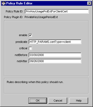

Private Key Usage Period Extension Policy |
The PrivateKeyUsagePeriodExt plug-in module implements the private key usage period extension policy. This policy enables you to configure Certificate Management System to add the Private Key Usage Period Extension defined in X.509 and PKIX standard RFC 2459 (see http://www.ietf.org/rfc/rfc2459.txt) to certificates. The extension allows the certificate issuer to specify a different validity period for the private key than the one specified for the corresponding certificate. The extension is intended for use with digital signature keys.
The PKIX standard recommends against the use of this extension. The standard also recommends that CAs conforming to the standard must not generate certificates with private key usage period extensions that are marked critical. For general guidelines on setting this extension in certificates, see "privateKeyUsagePeriod" in Appendix B of Netscape Certificate Management System Installation and Deployment Guide.
The private key usage period extension policy in Certificate Management System allows setting of the private key usage period extension as defined in its X.509 definition. The policy enables you to specify values for the notBefore and notAfter components. When included in a certificate, the notBefore and notAfter components define the time before and after which the private key associated with the certificate should not be used to sign objects.
PrivateKeyUsagePeriodExt Module
The Java class that implements the private key usage period extension policy is as follows:
com.netscape.certsrv.policy.PrivateKeyUsagePeriodExt
Figure 18.25 shows how the configurable parameters for the PrivateKeyUsagePeriodExt module are displayed in the CMS window.
Figure 18.25 Parameters defined in the PrivateKeyUsagePeriodExt module
The configuration shown in Figure 18.25 creates a policy rule named PrivKeyUsagePrdExtForClientCert, which enforces a rule that the server should set the private key usage period extension in client certificates.
Table 18.24 provides details for each of these parameters.

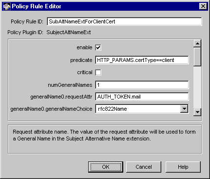

Subject Alternative Name Extension Policy |
The SubjectAltNameExt plug-in module implements the subject alternative name policy. This policy enables you to configure Certificate Management System to add the Subject Alternative Name Extension defined in X.509 and PKIX standard RFC 2459 (see http://www.ietf.org/rfc/rfc2459.txt) to certificates. The extension enables you to bind additional identities--such as Internet electronic mail address, a DNS name, an IP address, and a uniform resource indicator (URI)--to the subject of the certificate.
The standard suggests that if the certificate subject field contains an empty sequence, then the subject alternative name extension must contain the subject's alternative name and that the extension be marked critical. For general guidelines on setting the subject alternate name extension in certificates, see "subjectAltName" in Appendix B of Netscape Certificate Management System Installation and Deployment Guide.
The subject alternative name extension policy in Certificate Management System enables you to include values of certificate-request attributes in the extension. You can include any number of attributes as long as the attribute values conform to any of the supported general-name forms: rfc822Name, X.500 directory name, DNS name, EDI party name, URL, IP address, object identifier, and Other name.
Attributes in a certificate request are filled in by servlets from the HTTP input forms used for request submission. Some attributes, such as passwords typed in the form are not stored in the request. Other attributes regarding the end entity, such as the user ID, are set on the request after successful authentication. The servlets can also set additional attributes related to the certificate content on the request; for example, in automated-enrollment methods, some attributes may be read from the authentication directory and set in the request as authenticated attributes.
If you're using any of the directory-based authentication methods, you can configure Certificate Management System to retrieve values for any string and byte attributes from the directory and set them in the certificate request during authentication--you specify these attributes by entering them in the ldapStringAttributes and ldapByteAttributes fields defined in the automated enrollment modules. For more information, see Table 10.2, Table 10.3, and Table 10.4.
Note that all data related to an end entity is gathered at the servlet level and set on the request before the request is passed to the policy subsystem.
In general, you can configure which attributes should or shouldn't be stored in the request; for example, you can exclude sensitive attributes such as passwords from getting stored in the request with the help of the parameter named dontSaveHttpParams defined in the CMS configuration file. For details on using this parameter, see the description for HTTP_PARAMS in Table 24.9. You can also distinguish the attributes based on their origin--that is, whether they originated from the enrollment form or where added to the request during the authentication process. Authenticated attributes have AUTH_TOKEN as prefix (for example, AUTH_TOKEN.mail) and non-authenticated attributes such as the ones that come from the HTTP input have HTTP_PARAMS as prefix (for example, HTTP_PARAMS.csrRequestorEmail).
If enabled, the subject alternative extension policy checks the certificate request for configured attributes. If the request contains an attribute, the policy reads its value and sets it in the extension. This way, the extension that gets to added to certificates contains all the configured attributes.
During installation, Certificate Management System automatically creates an instance of the subject alternative name extension policy. See "SubjectAltNameExt Rule".
SubjectAltNameExt Module
The Java class that implements the subject alternate name extension policy is as follows:
com.netscape.certsrv.policy.SubjectAltNameExt
Figure 18.26 shows how the configurable parameters for the SubjectAltNameExt module are displayed in the CMS window.
Figure 18.26 Parameters defined in the SubjectAltNameExt module
The configuration shown in Figure 18.26 creates a policy rule named SubAltNameExtForClientCert, which enforces a rule that the alternative name of the certificate's subject must be derived from the mail attribute of subject's entry in the authentication directory and that the server should set the subject alternative name extension only in client certificates.
Table 18.25 provides details for each of these parameters.
The policy rule named SubjectAltNameExt is an instance of the SubjectAltNameExt module. Certificate Management System automatically creates this rule during installation. By default, the rule is configured as follows:
For details on individual parameters defined in the rule, see Table 18.25. You need to review this rule and make the changes appropriate for your PKI setup. For instructions, see "Step 2. Modify Existing Policy Rules". For instructions on adding additional instances, see "Step 4. Add New Policy Rules".
Before you edit the default rule, you should read the additional details about the attributes that are set in the default policy rule.
The first two attributes, AUTH_TOKEN.mail and AUTH_TOKEN.mailalternateaddress, are standard LDAP attributes typically used for storing end users' email addresses in an LDAP directory. These attributes enable you to include a user's email address as an alternative name in the certificate. Remember that you need to specify the LDAP attribute for users' email addresses as a part of configuring the server to use a specific directory for authentication--which means for the default rule to set end users' email addresses in the subject alternative name extension, you must ensure the following:
The third attribute, HTTP_PARAMS.csrRequestorEmail, is the email component of the subject name in an enrollment request--it is an HTTP input value that gets added to the request when a user uses the manual enrollment form; for details, see "Enrollment Forms".
If you enable the default policy rule, the server automatically checks the certificate request for attributes AUTH_TOKEN.mail, AUTH_TOKEN.mailalternateaddress, and HTTP_PARAMS.csrRequestorEmail. If the server finds any of the attributes, it sets the attribute value in the extension and then adds the extension to certificates specified by the predicate parameter. If none of the attributes are in a request, the server does not add the subject alternative name extension to the certificate.

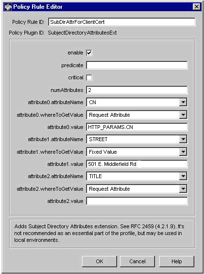

Subject Directory Attributes Extension Policy |
The SubjectDirectoryAttributesExt plug-in module implements the subject directory attributes extension policy. This policy enables you to configure Certificate Management System to add the Subject Directory Attributes Extension defined in X.509 and PKIX standard RFC 2459 (see http://www.ietf.org/rfc/rfc2459.txt) to certificates. The extension is used to specify any desired directory attribute values for the subject of the certificate.
As per the PKIX standard, inclusion of this extension in certificates is not essential; the standard suggests that the extension may be used in local environments. For general guidelines on setting the subject directory attributes extension, see "subjectDirectoryAttributes" in Appendix B of Netscape Certificate Management System Installation and Deployment Guide.
The subject directory attributes extension policy in Certificate Management System allows you to include up to three directory attributes in the extension. For each attribute that you want to include in the extension, you need to specify the attribute name and its value--the name must be the X.500 directory attribute name itself and the attribute value can be derived from the request or directly entered in the policy configuration as a string value.
The list of directory attributes supported by default are shown as permissible values for the attribute<n>.attributeName parameter explained in Table 18.26. You can extend the list of attributes supported by the policy by defining new X.500 directory attributes. For details on defining new attributes, see "Extending Attribute Support".
Note that, during installation, Certificate Management System does not create an instance of the subject directory attributes extension policy. If you want the server to add this extension to certificates, you must create an instance of the SubjectDirectoryAttributesExt module and configure it. For instructions, see "Step 4. Add New Policy Rules".
SubjectDirectoryAttributesExt Module
The Java class that implements the subject directory attributes extension policy is as follows:
com.netscape.certsrv.policy.SubjectDirectoryAttributesExt
Figure 18.27 shows how the configurable parameters for the SubjectDirectoryAttributesExt module are displayed in the CMS window.
Figure 18.27 Parameters defined in the SubjectDirectoryAttributesExt module
The configuration shown in Figure 18.27 creates a policy rule named SubDirAttrForClientCert, which enforces a rule that the server should set the subject directory attributes extension in client certificates.
Table 18.26 provides details for each of these parameters.

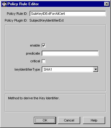

Figure 18.28 shows how the configurable parameters for the SubjectKeyIdentifierExt module are displayed in the CMS window.
Figure 18.28 Parameters defined in the SubjectKeyIdentifierExt module
The configuration shown in Figure 18.28 creates a policy rule named SubKeyIDExtForAllCert, which enforces a rule that the server should set the subject key identifier extension in all certificates.
Table 18.27 provides details for each of these parameters.
