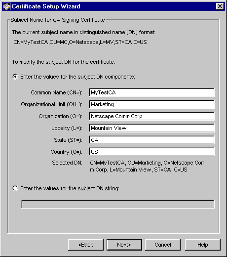

CA Signing Key Pair and Certificate
Every Certificate Manager you installed has a certificate, identified as the Certificate Manager CA signing certificate, whose public key corresponds to the private key the Certificate Manager uses to sign the certificates it issues. The first time you generated this certificate is when you installed the Certificate Manager. The default nickname for the certificate is
caSigningCert cert-<instance_id>, where <instance_id> identifies the CMS instance in which the Certificate Manager is installed, and the default validity period for the certificate is two years.
The subject name of the CA signing certificate reflects the name of your certificate authority (CA) as specified during the installation. All certificates signed or issued by the Certificate Manager include this name to identify the issuer of the certificate.
Important You cannot change the CA name; doing so would make all previously issued certificates invalid.

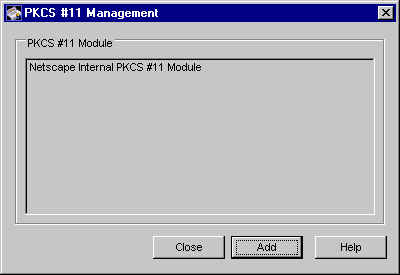

Step 2. Install the PKCS #11 Module
PKCS #11 is a standard set of APIs and shared libraries used by Netscape and a number of encryption vendors. PKCS #11 isolates an application from the details of the cryptographic device, thus enabling the application to provide a unified interface for PKCS #11-compliant cryptographic devices.
The PKCS #11 module implemented in Certificate Management System (in Netscape Administration Server) enables it to support cryptographic devices supplied by many different manufacturers. Specifically, it allows Certificate Management System to plug in shared libraries or DLLs supplied by manufacturers of external encryption devices and use them for generating and storing keys and certificates for the Certificate Manager, Registration Manager, and Data Recovery Manager.
There are two ways in which you can install a PKCS #11 module, by using the interface provided within Netscape Console or by using the command-line utility named modutil. Both the methods are documented in the sections that follow.

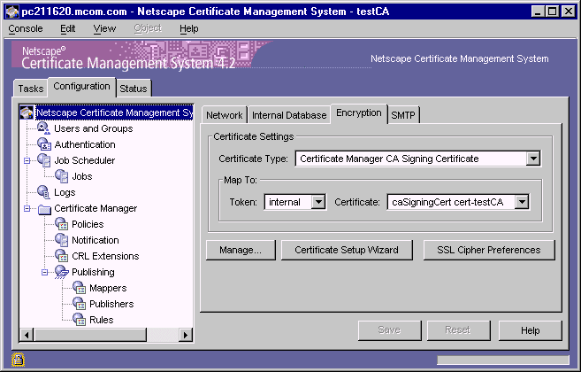

To view a list of the tokens currently installed for a CMS instance:
  1. Log in to the CMS window (see "Logging In to the CMS Window").
  2. Select the Configuration tab, and then in the right pane, select the Encryption tab.
  3. In the Map To section, check the Token drop-down list.
  4. It shows the names (as specified when the tokens were installed) of external tokens installed for the currently selected CMS instance. For information on installing external tokens, see "External Token".

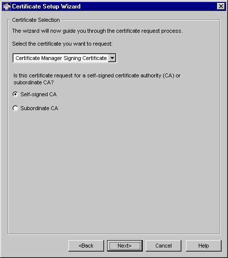

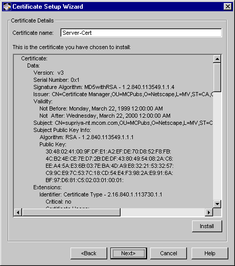

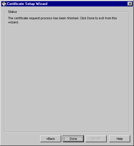

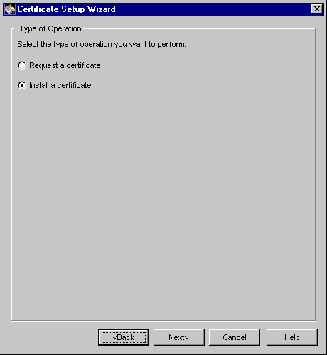

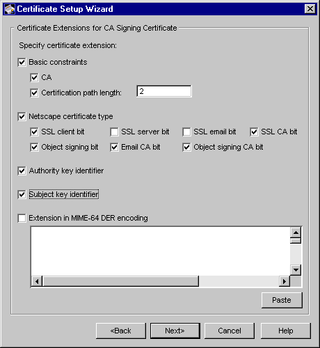

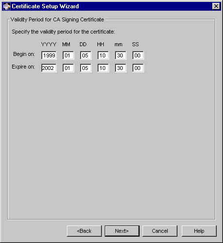

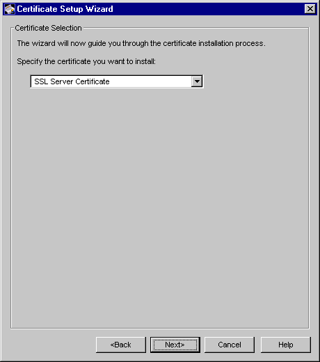

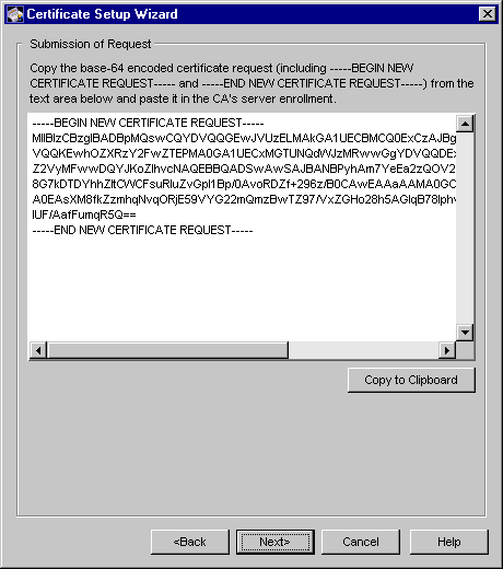

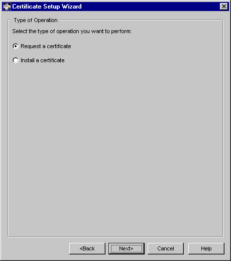

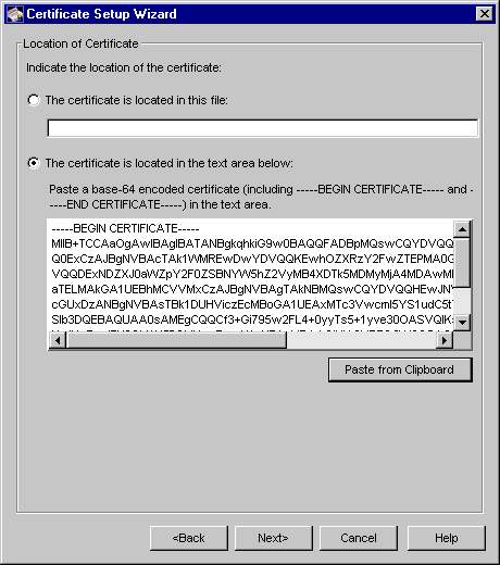

Certificate Setup Wizard
Certificate Management System provides a wizard, called the Certificate Setup Wizard, which automates the process of requesting and installing the certificates required by Certificate Management System. (For a description of these certificates, see "Keys and Certificates for the Main Subsystems".)
The Certificate Setup Wizard is integrated into the CMS window, enabling you to accomplish the following tasks:
When you start the wizard, which you do by clicking the Certificate Setup Wizard button in the Encryption tab of the CMS window (see the figure on page 238), you are asked to specify whether you want to request or install a certificate. The wizard presents you with the screens appropriate to your choice and walks you through the entire process.
For installing certificates, except for cases when the certificate is self-signed by the CA, you will need to run the wizard twice: once, to request the certificate and once to install the certificate. The reason for this is, if you submit the certificate request to a non-local CA, you will have to wait for the certificate until it is delivered to you.
The following sections explain the process of requesting and installing a certificate by using the Certificate Setup Wizard:

Step 1. Select the Operation
Indicate whether you want to request a certificate or install a certificate.
For the sake of completing the instructions that follow, assume that you chose to request a certificate.
Step 2. Choose the Certificate
Choose the certificate (by name) that you want to request.
The drop-down list shows various certificates used by the currently selected CMS instance. Choose the one you want to request. (If you need information on certificates used by Certificate Management System, see "Keys and Certificates for the Main Subsystems".)
Which certificates you see in the list depends on the subsystems installed in the currently selected CMS instance. You may see a combination of the following options:
Depending on the certificate you want to generate, choose the one in the drop-down list:

Step 4. Specify the Subject Name for the Certificate
Specify the subject name, in distinguished name (DN) format, for the certificate to be requested. Note that you will see this screen only if you chose to generate the certificate for a new key pair.
You can either enter values for individual DN attributes required to build the subject DN or build the complete subject DN string yourself. If you enter values for individual DN attributes, the wizard constructs the subject DN string.
If you want to enter values for individual DN components, provide the following information:
Important When choosing subject names for certificates, be sure to follow the information provided in "Role of Distinguished Names in Certificates".
Step 5. Specify the Validity Period
You need to complete this step only if you chose to generate a self-signed CA certificate request.
Specify the starting and ending dates of the validity period for the certificate request you want to generate. You can also specify the time at which the validity period should start and end on those dates. The date and time are in the form YYYYMMDD (Year, Month, Day) and HHmmSS (Hour, Minute, Second), in that order.
The default validity period is two years.
Step 6. Specify Extensions
You need to complete this step only if you chose to generate a CA signing certificate request for a Certificate Manager (deployed as either the root CA or a subordinate CA).
This screen allows you to set the standard X.509 version 3 extensions and Netscape-defined extensions for the certificate to be requested. The required extensions are chosen by default. If you want to change the default choices, be sure to read the general guidelines explained in "Certificate Extensions" in Appendix B of Netscape Certificate Management System Installation and Deployment Guide.
Also note that certificate extensions are required if you are setting up a hierarchy of certificate authorities (CAs). Subordinate CAs must have certificates that include the extension identifying them as either a subordinate SSL CA (which allows them to issue certificates for SSL) or a subordinate email CA (which allows them to issue certificates for secure email). If you disable certificate extensions, you will not be able to set up CA hierarchies. For more information on CA hierarchies, see "Certificate Hierarchies" in Appendix D of Managing Servers with Netscape Console.
You can set the following extensions:

Step 7. Copy the Certificate Signing Request
Based on the information you've entered in the previous steps, the wizard now displays the certificate signing request (CSR).
The request is in a base-64 encoded PKCS #10 format and is bounded by the marker lines -----BEGIN NEW CERTIFICATE REQUEST----- and -----END NEW CERTIFICATE REQUEST-----.
An example is show below:
MIICJzCCAZCgAwIBAgIBAzANBgkqhkiG9w0BAQQFADBC6SAwHgYDVQQKExdOZXRzY2FwZSBDb21td W5pY2F0aW9uczngjhnMVQ2VydGlmaWNhdGUgQXV0aG9yaXR5MB4XDTk4MDgyNzE5MDAwMFoXDTk5M DIyMzE5MDAwMnbjdgngYoxIDAeBgNVBAoTF05ldHNjYXBlIENvbW11bmljYXRpb25zMQ8wDQYDVQQ LEwZQZW9wbGUxFzAVBgoJkiaJkIsZAEBEwdzdXByaXlhMRcwFQYDVQQDEw5TdXByaXlhIFNoZXR0e TEjMCEGCSqGSIb3DbndgJARYUc3Vwcml5Yhvfggsvwryw4y7214vAOBgNVHQ8BAf8EBAMCBLAwFAY JYIZIAYb4QgEBAQHBAQDAgCAMA0GCSqGSIb3DQEBBAUAA4GBAFi9FzyJlLmS+kzsue0kTXawbwamG dYql2w4hIBgdR+jWeLmD4CP4xzmKdvQ6IqD2q8DBs9lRQu9JYg129oaCLpZfMNTPnMc3WPKO2pWZW Um7waHEtdbo9vSpbJkXTM/2GhWbsO5vLdeOxrPGxihkHgV/ vmqCl4HW7AorqGgyfygbhgthgutrhryj
Do not modify the CSR; you must send it to the CA as it is.
Copy the CSR, including the marker lines -----BEGIN NEW CERTIFICATE REQUEST----- and -----END NEW CERTIFICATE REQUEST-----, to a text file. If you are running the wizard on a Windows NT system, you can also copy the CSR to the Windows clipboard. In a Unix system, you may have to open an application, such as Netscape Composer, with a clipboard.
The wizard also copies the CSR to a text file it creates in the configuration directory, which is located at

Step 8. Check the Certificate Request Status
The wizard now informs you of the status of the request.
For the sake of completing the instructions that follow, assume that you chose to install a certificate.
Step 2. Select the Certificate or Certificate Chain
Select the certificate you want to install.
The drop-down list shows various options:
Depending on whether you want to install a CMS certificate, any other trusted CA certificate, or a CA certificate chain, choose the appropriate option from the list box:
Step 3. Specify the Location of the Certificate
Locate the certificate or certificate chain you want to install.
You can keep the certificate or certificate chain in a text file or copy it to the text area on the wizard screen. Here is some information that will help you decide on the location.
Step 4. View the Certificate or Certificate Chain
The wizard displays the certificate or certificate chain you have chosen to install. Make sure you have chosen the right one; otherwise, use the Back button to go back and locate the right one. Specify a nickname for the certificate.
Step 5. Install the Certificate or Certificate Chain
The wizard shows the certificate or certificate chain information you have selected for installing. You should check the information to make sure that you have chosen the correct one for installing.
After verifying that the certificate you have chosen is the correct one, click the Install button. The wizard installs the certificate or the CA chain in the token you have chosen.

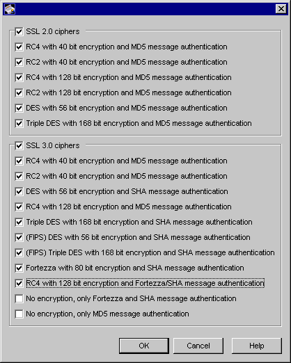

Setting Up Cipher Preferences for SSL Communications
A cipher is the algorithm used in encryption. Some ciphers have stronger encryption capabilities than others. Generally speaking, the more bits a cipher uses during encryption, the harder it is to decrypt the data.
When a client initiates an SSL connection with Certificate Management System, it lets the server know what ciphers it prefers to use to encrypt information. In any two-way encryption process, both parties must use the same ciphers. A number of ciphers are available; your server needs to be able to use the most popular ones.
SSL Ciphers Supported in Certificate Management System
Figure 8.1 shows the ciphers supported by Certificate Management System (on the server side). The figure shows SSL 2.0 and 3.0 ciphers supported in the domestic (US and Canada) version of Certificate Management System. Note that Certificate Management System has received retail status from the United States Department of Commerce Bureau of Export Administration; under new regulations, retail status makes it possible to export Certificate Management System with the same encryption and cryptographic features available in the US and Canada. For more information, see Appendix E, "Export Control Information" of Netscape Certificate Management System Installation and Deployment Guide.
Figure 8.1 SSL version 2.0 and 3.0 cipher suites supported (in the domestic version)
You can choose ciphers from the SSL 2.0 protocol, as well as from SSL 3.0. To specify which ciphers your server can use, check them in the list of ciphers to enable them. Unless you have a compelling reason not to use a specific cipher, you should check them all, except as noted in the warning that follows. For a detailed description of ciphers, see "Ciphers Used with SSL" in Appendix E of Managing Servers with Netscape Console.
Warning You might not want to check the options that say "No Encryption, only MD5 message authentication" and "No Encryption, only Fortezza and SHA message authentication." The reason for this is, if no other ciphers are available on the client side, the server will use these and no encryption will occur.

Configuring the Server to Use Specific Ciphers
You can set a number of systemwide preferences for SSL by specifying the ciphers that Certificate Management System should recognize and use during SSL communication; the server applies the cipher settings you choose to all the SSL (HTTPS) ports it uses.
To change the cipher settings for a CMS instance:
  3. Click SSL Cipher Preferences, and choose the appropriate options.
  4. For details, see "Setting Up Cipher Preferences for SSL Communications".
  5. Click OK.
  6. You are returned to the Encryption tab.
  7. To save your changes, click Save.
  8. The CMS configuration is modified. If the changes you made require you to restart the server, you will be prompted accordingly. In that case, restart the server.

Determine certificate formulation information
Decide on the subject DN and nickname for the certificate you want generate. Also decide on details such as the key algorithm, key size, extensions, and validity period for the certificate.
Step 2. Request the New Certificate
Once you have all the information, go ahead and request the certificate. The Certificate Setup Wizard built into the CMS window automates the process of requesting certificates used by the Certificate Manager, Registration Manager, and Data Recovery Manager. You can use this wizard to generate a new certificate request and submit the request to any CA for signing. For instructions, see "Using the Wizard to Request a Certificate".
Step 3. Install the New Certificate
When you receive the certificate from the CA, you must install it in the token that contains the key pair for this certificate; it must be the token you used to generate the request in Step 2.
The Certificate Setup Wizard automates the process of installing certificates used by the Certificate Manager, Registration Manager, and Data Recovery Manager. You may use this wizard to install the new certificate. For instructions, see "Using the Wizard to Install a Certificate or Certificate Chain".

Step 2. Renew the Existing Certificate
Once you have all the information, go ahead and renew the certificate. The Certificate Setup Wizard built into the CMS window automates the process of renewing certificates used by the Certificate Manager, Registration Manager, and Data Recovery Manager. The wizard can generate a certificate request based on the existing key pair and submit the request to a CA for signing. For instructions on using the wizard, see "Using the Wizard to Request a Certificate".

If you set the validity period of the renewed certificate to begin on a future date and time, the server fails to use the certificate for its intended purposes. If this happens, you may either reinstall the old certificate (saved to the text file mentioned above) or renew the certificate again with an appropriate validity period.
Step 3. Install the Renewed Certificate
When you receive the renewed certificate from the CA, you must install it in the token that contains the key pair for the certificate; this is the token you used to generate the request in Step 2.
The Certificate Setup Wizard automates the process of installing certificates used by the Certificate Manager, Registration Manager, and Data Recovery Manager. For instructions on using the wizard, see "Using the Wizard to Install a Certificate or Certificate Chain".

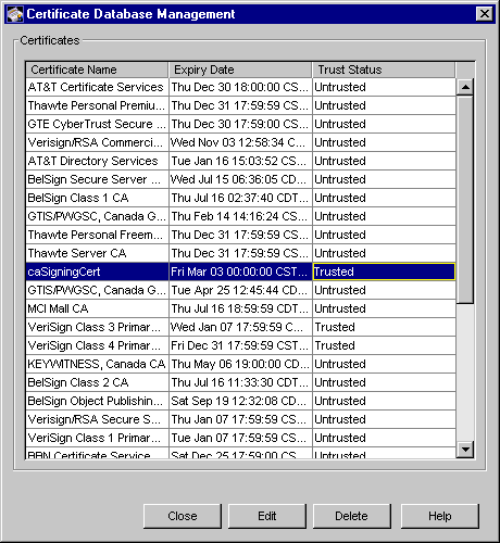

Each CMS instance has a certificate database that contains the list of certificates the server uses.
To view the contents of the database:
  3. Click Manage Certificate.
  4. The Certificate Database Management window appears.
    The window lists the certificates in a table, with each certificate occupying a row. The certificates are listed in alphabetical order. If the database contains multiple certificates with the same nickname, they are sorted by their validity periods; the most recently requested certificate is placed at the top.
    For each certificate, you see the following information:
    Certificate Name. Specifies the nickname of the certificate.
    Expiry Date. specifies the date (and time) on which the certificate expires.
    Trust Status. Specifies whether the CA is trusted or untrusted. To change the trust setting, see "Changing the Trust Settings of a CA Certificate".
  4. The Certificate Database Management window appears. The window lists all the certificates for the selected instance of Certificate Management System; the list is a table, with each certificate occupying a row.
  5. Select the CA certificate you want to delete, and click Delete.
  6. When prompted, confirm the delete action.
  7. Click Close.
  8. You are returned to the Encryption tab.
  9. To save your changes, click Save.
  10. The CMS configuration is modified. If the changes you made require you to restart the server, you will be prompted accordingly. In that case, restart the server.

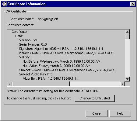

  5. Select the CA certificate whose trust setting you want to modify, and click Edit.
  6. The Certificate Information window appears.
    The window shows detailed information about the selected certificate, including serial number, validity period, subject name, issuer name, certificate fingerprint, and trust status.
    If the certificate you selected is currently trusted, the window shows a button named "Change to Untrusted." If it is untrusted, the window shows a button named "Change to Trusted."
  7. Click "Change to Untrusted" or "Change to Trusted," as appropriate.
  8. Click Close.
  9. You are returned to the Certificate Database Management window. The certificate now shows a different trust status.
  10. Click Close.

Installing a New CA Certificate in the Certificate Database
You may need to install new trusted CA certificates in the certificate database of a CMS instance. For example, assume that you renewed the signing certificate of a Registration Manager. Also assume that the CA that signed the Registration Manager's certificate is not included in the trust database of the Certificate Manager that has been configured to sign certificate requests from this Registration Manager.
When the Registration Manager attempts to request a service from the Certificate Manager (using the renewed certificate for SSL client authentication), the Certificate Manager fails to authenticate the Registration Manager. This happens because, as a part of validating the certificate presented by the Registration Manager, the Certificate Manager checks its certificate database for the CA that signed the Registration Manager's certificate. The Certificate Manager does not find the CA listed in its trust database as a trusted CA, so it rejects the Registration Manager's service request.
The Certificate Setup Wizard built into the CMS window automates the process of installing trusted CA certificates in the certificate database. For instructions on using the wizard, see "Using the Wizard to Install a Certificate or Certificate Chain".
Important Be sure to choose the "Other Trusted CAs" option in Step 2 of the wizard process.
