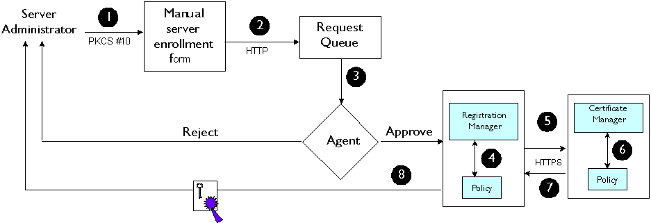

How the Manual Server Enrollment Process Works
Figure 27.1 illustrates how Certificate Management System issues a server certificate in a deployment scenario involving a Registration Manager acting as an enrollment authority to a Certificate Manager. The server certificate is requested via a manual enrollment form hosted by the Registration Manager.
Figure 27.1 Server (or site) certificate issuance
These are the steps shown in Figure 27.1:
  1. The server administrator goes to the manual enrollment form hosted by the Registration Manager, pastes in the certificate signing request in PKCS #10 format, completes the other information in the enrollment form, and submits the form.
  2. (If the enrollment port is HTTPS, the administrator should visit the link that delivers the CA's certificate chain and download the chain into the browser that he or she will use for server enrollment.)
  3. The Registration Manager verifies the authenticity of the request. Because the request requires manual authentication, the Registration Manager stores the request in the queue for agent approval.
  4. An agent processes the request and either rejects or approves it.
  5. The Registration Manager picks up the approved request and subjects it to policy checks.
  6. If the request passes the Registration Manager's policy checking, the Registration Manager submits the request to the Certificate Manager for signing. The Certificate Manager verifies the authenticity of the Registration Manager by verifying the certificate presented by it. If it is a trusted Registration Manager, the Certificate Manager accepts the request.
  7. The Certificate Manager subjects the request to its own policy checks.
  8. If the request passes Certificate Manager's policy, it signs the request immediately and returns the certificate to the Registration Manager. The Registration Manager then delivers the certificate to the administrator. Optionally, the Certificate Manager may publish the certificate to the corporate directory.
  9. If the Certificate Manager's policy requires additional information, the administrator will be directed to return later to pick up the certificate. The administrator may need to query the Registration Manager using the certificate request number to see whether the certificate has been issued. Alternatively, the Registration Manager can be configured to email the user when the certificate is ready for pick up. See "Notifications of Certificate Issuance to End Entities".
  10. The Registration Manager delivers the server SSL certificate to the email address specified in the enrollment form. Optionally, the Registration Manager may publish the certificate to the corporate directory.

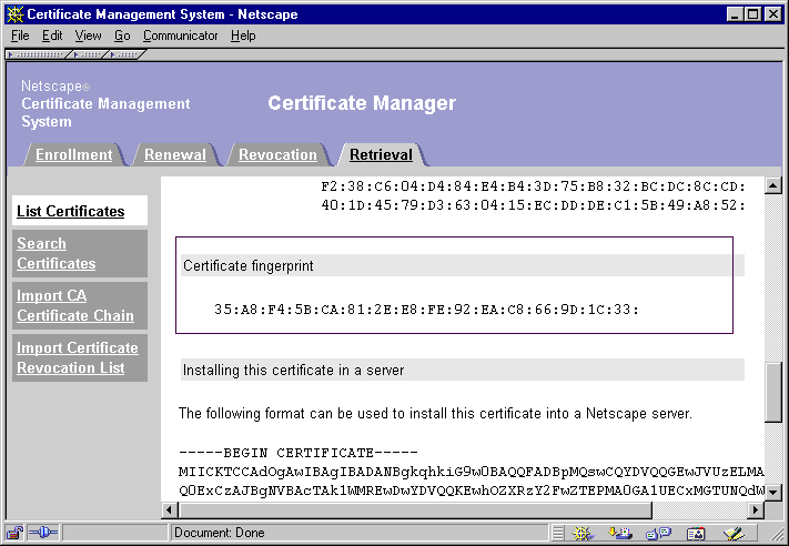

To view this chain in a format that can be used by Netscape servers:
  1. Go to the home page of Certificate Management System.
  2. By default, the home page is at this location:
    https://<host_name>:<end_entity_HTTPS_port>
  3. Click Accept "This Authority in Your Server."
  4. Specify how you want Certificate Management System to display the certificate chain.
  5. You can choose to display the entire certificate chain (in a single block) or individual certificates in the chain. The entire certificate chain is in PKCS #7 format. If you are using an older server that does not recognize the complete certificate chain format, you may need to display each individual certificate in the chain (for example, a version earlier than Netscape server 2.0 releases).
  6. Specify how you want to trust this CA.
  7. You can choose to trust only the CA you are accessing or all authorities whose certificates are included in the chain.
  8. Click Present Certificate Chain.
  9. If you chose to display the whole chain for importing into your server, the certificate chain is displayed in a format similar to this:
    -----BEGIN CERTIFICATE-----
    MIIBtgYJYIZIAYb4QgIFoIIBpzCCAZ8wggGbMIIBRaADAgEAAgEBMA0GCSqGSIb3DQEBBAUAMFcxC zAJBgNVBAYTAlVTMSwwKgYDVQQKEyNOZXRzY2FwZSBDb21tdW5pY2F0aW9ucyBDb3Jwb3JhdGlvbj EaMBgGA1UECxMRSXNzdWluZyBBdXRob3JpdHkwHhcNOTYxMTA4MDkwNzM0WhcNOTgxMTA4MDkwNzM 0WjBXMQswCQYDVQQGEwJVUzEsMCoGA1UEChMjTmV0c2NhcGUgQ29tbXVuaWNhdGlvbnMgQ29ycG9y YXRpb24xGjAYBgNVBAsTEUlzc3VpbmcgQXV0aG9yaXR5MFowDQYJKoZIhvcNAQEBBQADSQAwRgJBA OBiQPcK8851jjQXA2GBsaKNFg6pYaM3qhQhM0w5EIy6P1ttMjc5MlPIzZHdlgNdQLzaNoLMVKjOV5 sBp+ffkCAQMwDQYJKoZIhvcNAQEEBQADQQCWPU4gI5uaWM3EAbXfhQ
    -----END CERTIFICATE-----

Step 3. Request the CA's Certificate
In this part of the operation, you identify the CA to the router, thus enabling the router to authenticate the CA from which it will request the certificate. You also verify whether the router is talking to the right CA; you do this manually.
Here's what you should do:
  1. Run the appropriate command to get the CA certificate.
  2. The command will ask you to specify the following:
  3. The router gets the CA certificate and displays its fingerprint on your screen.
  4. Verify the fingerprint on your screen with the one you noted down in
    Step 1.
  5. If it matches, the router is talking to the right CA.

As an administrator, you can configure a Certificate Manager or Registration Manager to automatically notify end users to renew their certificates before the current ones expire. If you enable this feature, the subsystem periodically queries the internal database for already expired or about to expire and not renewed already certificates, and alerts the user and you (optional) to imminent certificate expiration. For more information about this feature, see "Certificate Renewal Notifications".
Renewal of Server Certificates
Certificate Management System allows server administrators to renew their certificates by using the server enrollment form hosted by a Certificate Manager or Registration Manager. The renewal process is similar to the enrollment process in that the administrators must manually generate the certificate-signing request using the server's key pair, paste that request in the manual enrollment form, and submit the request. For details, see "Certificate Issuance to Servers".
Note For renewing the certificates of a Certificate Manager, Registration Manager, or Data Recovery Manager, see "Renewing Certificates for the Subsystems".
Certificate Revocation
Certificate Management System allows a certificate to be revoked by an end user (the original owner of the certificate), a server administrator, or by a Certificate Manager or Registration Manager agent. End users can revoke certificates by using the Revocation form provided in the end-entity services interface. Agents can revoke end-entity certificates by using the appropriate form in the Agent Services interface. Certificate-based (SSL client authentication) or challenge-password-based authentication is required in both cases; for details, see "Authentication of End Users During Certificate Revocation".
Upon receiving the list of certificates to be revoked, the Registration Manager formulates a CMMF request and sends it to the Certificate Manager. The Certificate Manager marks the corresponding certificate records in its certificate store (maintained in the internal database) as revoked and if configured to do so, removes the revoked certificates from the publishing directory and updates the CRL in the publishing directory.
