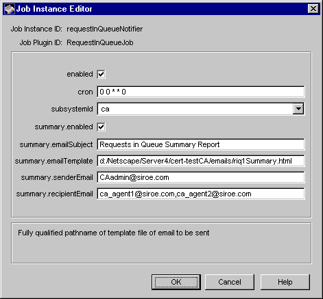

Notification of Request Queue Status
In addition to or instead of notifying agents of new requests, you might want to schedule a job that regularly notifies them of the status of the request queue. Such a job can check at a configured interval whether there are any deferred enrollment requests waiting for review. It can then send an email message to agents informing them of the number of requests waiting in the request queue for which they are responsible.
RequestInQJob Module
The java class that implements the job for request-queue-status notifications is identified as follows:
com.netscape.certsrv.jobs.RequestInQJob
This plug-in is a schedulable job. When an instance of the job is enabled, it gets activated at the configured interval and checks the status of the request queue. If any deferred enrollment requests are waiting in the queue, the job constructs an email message summarizing its findings and sends it to the specified agents.
The job constructs the summary message by using a template located in a configured directory. This directory has the following default location:
<server_root>/cert-<instance_id>/emails
You can configure the path and filename of the template file for each job and modify the templates to customize the contents and appearance of the messages. Messages can be sent as HTML or plain text.
For each instance of the RequestInQJob class, you can configure the following:
Figure 14.2 shows how the configurable parameters for the RequestInQJob module are displayed in the CMS window.
Figure 14.2 Parameters defined in the RequestInQJob module
Table 14.3 gives details for each of these parameters.
Table 14.3 Description of parameters defined in the RequestInQJob module
Parameter
Description
enabled
Specifies whether the job is enabled or disabled. Check the box to enable the job. Uncheck the box to disable the job. If you enable the job and set the remaining parameters correctly, the server runs the job at scheduled intervals.
cron
Specifies the cron specification for when this job should be run. This is the time at which the Job Scheduler daemon thread checks the queue for pending requests.
Permissible values: Must follow the convention specified in "Schedule for Executing Jobs"
Example: 00**0
subsystemid
Specifies the subsystem that this job is for.
Permissible values: ca or ra.
Example: ca
summary.enabled
Specifies whether a summary of the job accomplished should be compiled and sent. Check the box if you want the server to compose and send a summary report. Uncheck the box if you don't want the server to compose and send a summary report. If you check the box, be sure to set the remaining parameters; these are required by the server to send the summary report.
summary.
emailSubject
Specifies the subject line of the summary message.
Permissible values: An alphanumeric string of up to 255 characters.
Example: Summary Report of Requests in the Agent Queue
summary.
emailTemplate
Specifies the path, including the filename, to the directory that contains the template to be used for formulating the summary report. For details, see "Customizing Notification Messages".
Permissible values: The template file path, including the file name.
Example: C:/Netscape/Server4/cert-testCA/emails/reqInQJobSummary.txt
summary.senderEmail
Specifies the sender of the notification message (who should be notified of any delivery problems).
Permissible values: The full email address.
Example: CAadmin@siroe.com
summary.
recipientEmail
Specifies the recipients of the summary message. These should be, for example, agents who need to process pending requests.
Permissible values: Full email addresses, separated by commas.
Example: ca_agent1@siroe.com,ca_agent2@siroe.com
