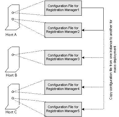

Duplicating a Configuration from One Instance to Another
If you have deployed a large number of CMS instances that are identical--for example, multiple Registration Managers--and you want all these instances to have the same configuration, you can accomplish this by configuring one of the instances and then replacing the configuration files of the other instances with the one that contains the required configuration. Figure 3.2 illustrates this quick way of deploying multiple Registration Managers with the same configuration.
Figure 3.2 Duplicating a configuration
Caution Be careful when replacing configuration of one instance with another. The configuration file for an instance contains instance-specific parameters. If you replace these parameters, the instance will fail to start or function properly.
