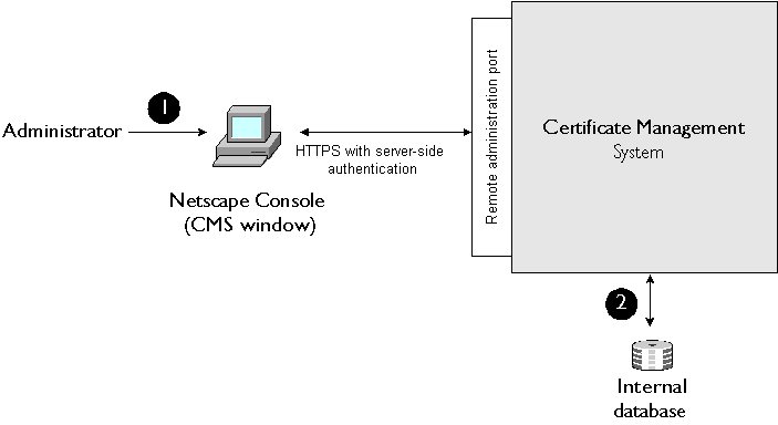

Authentication of Administrators
When an administrator makes an administrative request to Certificate Management System (from the CMS window within Netscape Console or from any command-line tool), the server needs to authenticate the administrator before processing the request. To facilitate this, Certificate Management System supports an authentication method that includes user ID- and password-based authentication from the client and SSL server authentication from the server.
Certificate Management System identifies and authenticates users with administrator privileges by checking their user IDs and passwords in its internal database. These are the user IDs and passwords you entered in the internal database when you created these user entries. For details, see "Setting Up Administrators".
Figure 9.1 illustrates the authentication process.
Figure 9.1 CMS authentication of a user with administrator privileges
These are the steps shown in Figure 9.1:
  1. An administrator opens Netscape Console and attempts to log in to the CMS window by entering the user ID and password at the login prompt. The server takes the administrator's user ID and password and binds them to privileged-user entries in its internal database.
  2. If the user ID and password bind successfully to a user entry, authentication succeeds; otherwise, it fails.
  3. If both authentication and authorization succeed, the server services the request. Otherwise, it rejects the request and logs the reason for the rejection.
Note Authentication for administrators is hardcoded; it is not configurable.

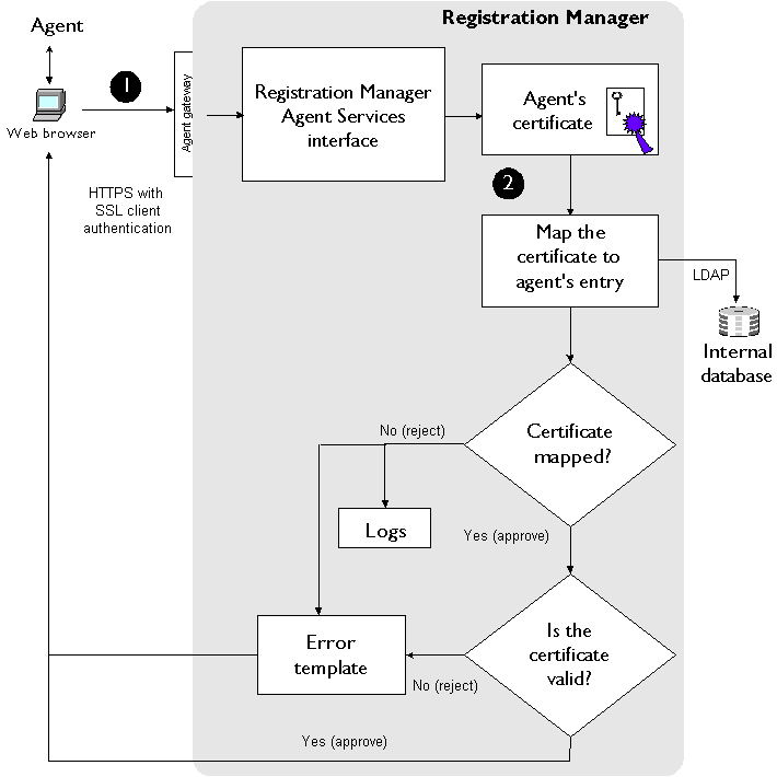

Authentication of Agents
When an agent makes a request to Certificate Management System (from the appropriate Agent Services interface), the server needs to authenticate the agent before processing the request. To facilitate this, Certificate Management System supports a certificate-based authentication method.
Certificate Management System identifies and authenticates a user with agent privileges by checking the user's SSL client certificate in its internal database. The certificates it checks are the ones you imported and stored in the internal database while creating or modifying the user entry. You create agent users for a CMS instance by adding their client certificates into the internal database and associating them with the corresponding users' identification information; for details, see "Setting Up Agents".
When an agent makes a request to perform a privileged operation, the server requests SSL client authentication from the client that the agent has used to connect to the server. The server then uses the successfully SSL client-authenticated certificate to map to internal user entries for further checks. The server checks the certificate's subject name and issuer name against the list of privileged-user certificates stored in its internal database. If the certificate belongs to a privileged user who is authorized (based on group membership) to perform agent operations, the server allows the user to perform the requested operation. Otherwise, the server rejects the request and logs an appropriate message (for details, see "Logs").
Note Authentication for agents is hardcoded; it is not configurable.
Figure 9.2 shows how a Registration Manager authenticates and authorizes a Registration Manager agent.
Figure 9.2 Registration Manager authentication of a user with Registration Manager agent privileges
This example shows these steps:
  1. An agent opens a web browser and enters the URL to the Registration Manager Agent Services interface hosted by the Registration Manager. The server requests the client for SSL client authentication. The client in turn prompts the agent to specify the certificate that it should present to the server for authentication. The successfully SSL client authenticated certificate is presented to the Registration Manager.
  2. Upon receiving the certificate, the Registration Manager performs the following authentication and authorization process:
  3. If both authentication and authorization succeed, the Registration Manager services the request. Otherwise, it rejects the request and logs a reason for the rejection.

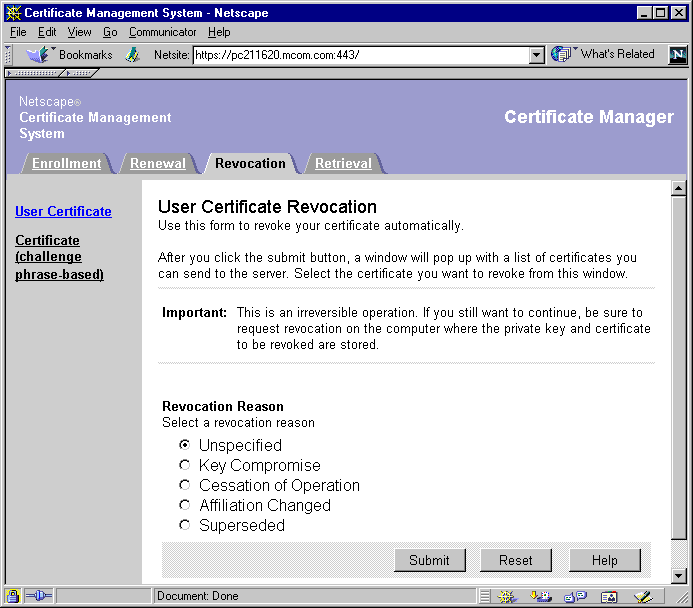

Certificate Revocation Forms
The End Entity Services interface of the Certificate Manager and Registration Manager includes default HTML forms for both the SSL client authenticated revocation and challenge-password-based revocation. The forms are accessible from the Revocation tab. Figure 9.4 shows the form that enables end users to revoke their certificates using a challenge password. You can view the form that enables SSL client authenticated revocation by clicking the User Certificate link.
Figure 9.4 Form for SSL client authenticated certificate revocation
If you want to change the forms to suit your organization's requirements, you can edit the following files:
Both the files are located here:
<server_root>/cert-<instance_id>/web/ee
For details on individual form elements, see the online help available by clicking the Help button on the form. For more information on customizing the form, see "Agent and End-Entity Interfaces".
