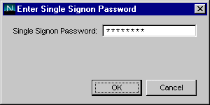

  5. When you start Certificate Management System, you are prompted to supply the single sign-on password for the server.
  6. Type the single sign-on password you specified during installation and click OK.
  7. Certificate Management System won't start until you provide this password. For more information, see "Required Start-up Information".

  3. When you restart Certificate Management System, you are prompted to supply the single sign-on password for the server.
  4. Type the single sign-on password you specified during installation and click OK.
  5. Certificate Management System won't restart until you provide this password. For more information, see "Required Start-up Information".
