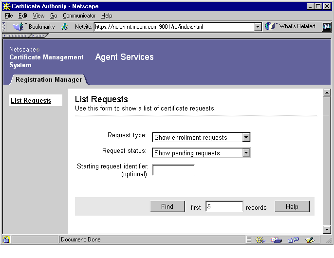

The Registration Manager Agent Services interface enables a Registration Manager agent to interact with the Registration Manager (the server). Figure 23.3 shows the Registration Manager Agent Services interface.
Figure 23.3 Registration Manager Agent Services interface
Using the default forms, a Registration Manager agent can list deferred certificate requests from end entities and process them.

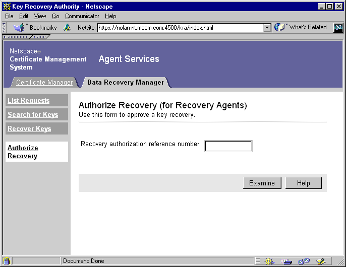

The Data Recovery Manager Agent Services interface enables a Data Recovery Manager agent to interact with the Data Recovery Manager (the server). Figure 23.4 shows the Data Recovery Manager Agent Services interface.
Figure 23.4 Data Recovery Manager Agent Services interface
Using the default forms, a Data Recovery Manager agent can search for and recover end users' encryption private keys from the key archive. (Key recovery requires authorization from key recovery agents; see "Key Recovery Process".)
