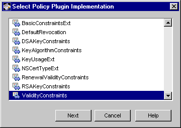

Add. The add operation shows a list of registered policy modules from which you can select the one you want to configure. When you save the changes, the subsystem creates the rule and displays it in the list of policy rules. For instructions, see "Step 4. Add New Policy Rules".

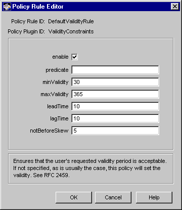

  7. For the purposes of this instruction, assume that you selected the rule named DefaultValidityRule.
  8. Click Edit/View.
  9. The Policy Rule Editor window appears, showing how this rule is configured. An example is shown below.
  10. Make the necessary changes and click OK.
  11. You are returned to the Policy Rules Management tab.
  12. Repeat steps 5 through 7 for the remaining rules.
  13. Click Refresh.
Adding a policy rule to the CMS configuration involves creating a new instance of an already registered policy plug-in module, assigning a unique name for the instance, and entering appropriate values for the parameters that define the module you want to create an instance of.
When you add a policy rule, the CMS configuration gets updated with policy-specific information. Keep the following points in mind:

  1. In the Policy Rules Management tab, click Add.
  2. The Select Policy Plugin Implementation window appears. It lists registered policy plug-in modules. The default modules are listed in Table 19.2.
  3. Select a plug-in module.
  4. For the purposes of this instruction, assume that you selected the ValidityConstraints module.
  5. Click Next.
  6. The Policy Rule Editor window appears. It lists the configuration information required for this policy rule.
  7. Enter the appropriate information.
  8. Policy Rule ID. Type a unique name that will help you identify the rule. Be sure to formulate the name using any combination of letters (aA to zZ), digits (0 to 9), an underscore (_), and a hyphen (-). For example, you can type My_Policy_Rule or MyPolicyRule as the instance name, but not My Policy Rule.
    enable. Check the box to enable the rule (default). If you enable the rule and set the remaining parameters correctly, the server sets the configured validity period in certificates specified by the predicate parameter.
    Uncheck the box to disable the rule. If you disable the rule, the server does not set the configured validity period in certificates; it sets the validity period to the one specified in the request.
    predicate. Type the predicate expression for this rule. If you want this rule to be applied to all certificate requests, leave the field blank (default). To form a predicate expression, see "Using Predicates in Policy Rules".
    minValidity. Type the minimum validity period, in days, for certificates. The value must be an integer greater than zero and less than the value you will type for the maxValidity parameter next. The default value is 180 days.
    maxValidity. Type the maximum validity period, in days, for certificates. The value must be an integer greater than zero and also greater than the value you typed for the minValidity parameter. The default value is 730 days.
    leadTime. Type the lead time, in minutes, for certificates. For a certificate renewal request to pass the renewal validity constraints policy, the value of the notBefore attribute in the certificate request must not be more than value of the leadTime parameter in the future, relative to the time when the policy rule is run. The default value is 10 minutes.
    The notBefore attribute value specifies the date on which the certificate validity begins.
    lagTime. Type the lag time, in minutes, for certificates. For a certificate renewal request to pass the renewal validity constraints policy, the value of the notBefore attribute in the certificate request must not be more than the value of the lagTime in the past, relative to the time when the policy is run. The default value is 10 minutes.
    The notBefore attribute value specifies the date on which the certificate validity ends.
    notBeforeSkew. Type the number of minutes to subtract from the current time when creating the value for the certificate's notBefore attribute. It can help some clients with incorrectly set clocks use the new certificate after downloading. For example, if the certificate is issued at 11:30 a.m. and the clock settings of the client into which the certificate is downloaded is 11:20 a.m., the certificate cannot be used for 10 minutes. Setting the value of the notBeforeSkew parameter to 10 minutes would adjust the value of the notBefore parameter to 11:20 a.m.--thus making the certificate usable following the down load. The default value is 5 minutes.
