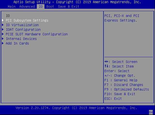

BIOS IO Menu Selections
This section includes a screen of the BIOS IO Menu. The options that are available from the IO Menu are described in the sections that follow.
image:This figure shows the BIOS IO Menu image.
The following sections describe the BIOS IO Menu options.
