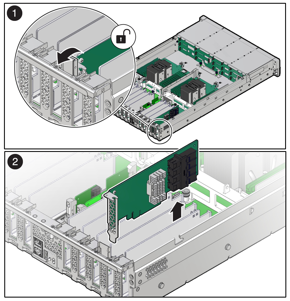

    Caution  -  If you are removing a hot-pluggable PCIe card, remove the PCIe card only when the green power LED is off. If you remove a card when the power is on, unexpected system operation can occur.
  2. Verify that the Do Not Service LED indicator light is off.
  3. Locate the PCIe card that you want to remove.
    See PCIe Slot Locations.
  4. If necessary, record where the PCIe cards are installed.
  5. Rotate the PCIe card locking mechanism in to an upright position [1], and lift up on the PCIe card to disengage it from the motherboard connectors [2].
    image:Figure showing a PCIe card being removed from the server.
  6. Place the PCIe card on an antistatic mat.
