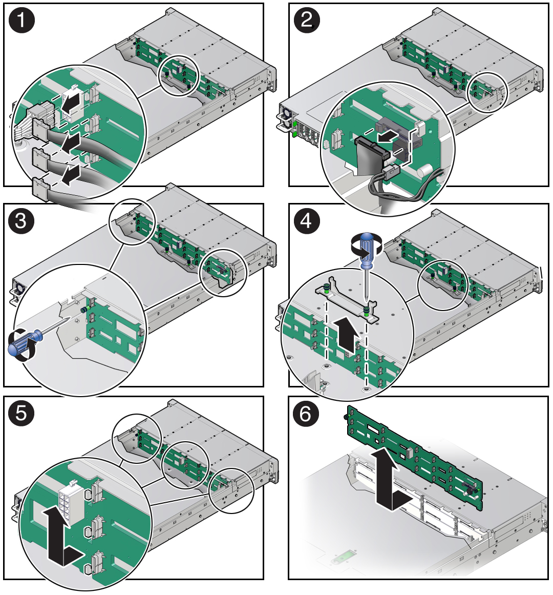

  3. Disconnect the cables from the disk backplane.
    1. Disconnect the power cable from the disk backplane [1].
    2. Disconnect the three SAS cables from the disk backplane [1].
      Press the green button on the connector while gently pulling the connector from the disk backplane. Note the cable connections in order to ease proper reconnection of the cables.
      image:Figure showing the disk backplane being removed from the                                     server.
    3. Disconnect the temperature sensor cable from the disk backplane [2].
    4. Disconnect the auxiliary signal cable from the disk backplane [2].
  4. Using a Torx T15 screwdriver, loosen the right-side and left-side spring-mounted screws that secure the disk backplane to the chassis [3].
  5. Using a Torx T25 screwdriver, loosen the spring-mounted screws that secure the backplane bracket to the chassis, and lift the bracket from the server [4].
  6. Lift the disk backplane up to release it from the standoff hooks and out of the chassis [5 and 6].
