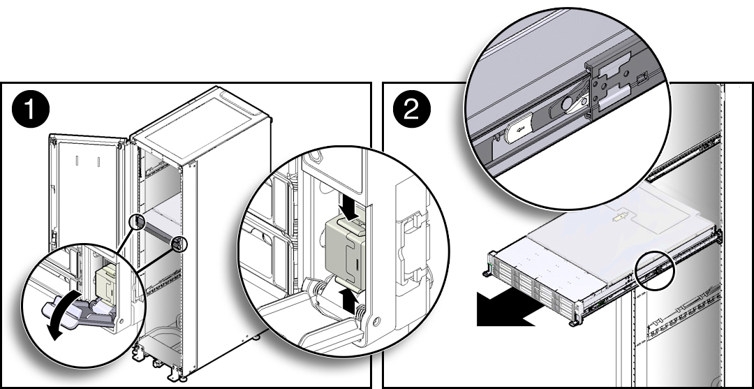

  3. From the front of the server, open and hold the left and right release latch covers in the open position.
    When in an open position, the release latch covers engage the slide-rail release latches [1].
    Caution
    Caution  -  Deploy any rack anti-tilt mechanism before releasing the slide-rail release latches.
    image:Figure showing the server being extended to the maintenance                                 position.
  4. While the release latch covers are in the open position, slowly pull the server forward until the slide-rails latch into a locked position [2].
    The server is now in the extended maintenance position.
