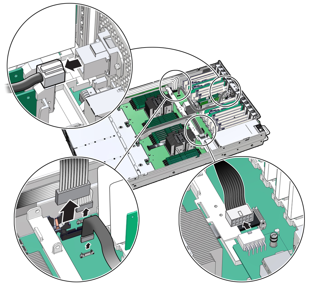

  4. Disconnect the following cables from the motherboard:
    image:Figure showing cables being disconnected from the motherboard                             assembly.

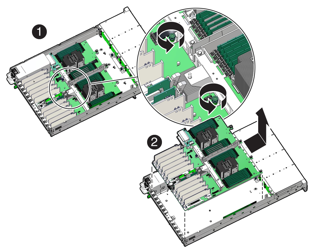

  5. Using a Torx T25 screwdriver, loosen the two captive screws that secure the motherboard mid-wall to the chassis [1].
    image:Figure showing the motherboard assembly being removed from the                             server.
  6. With the server in the extended maintenance position, remove the motherboard from the server with all reusable components that populate the motherboard in place [2].
    1. Carefully slide the motherboard forward, and while holding the motherboard mid-wall, lift it out of the chassis.
    2. Place the motherboard assembly on an antistatic mat, and next to the replacement motherboard.

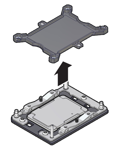

    1. Grasp the processor socket cover finger grips (labeled REMOVE) and lift the socket cover up and off the processor socket.
      image:Figure showing how to remove the processor socket                                     cover.

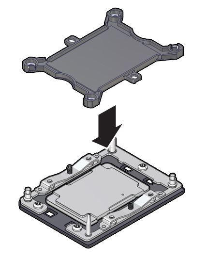

    1. Align the processor socket cover over the processor socket alignment posts. Install the processor socket cover by firmly pressing down on all four corners (labeled INSTALL) on the socket cover.
      You hear an audible click when the processor socket cover is securely attached to the processor socket.
      image:Figure showing how to install the processor socket                                     cover.

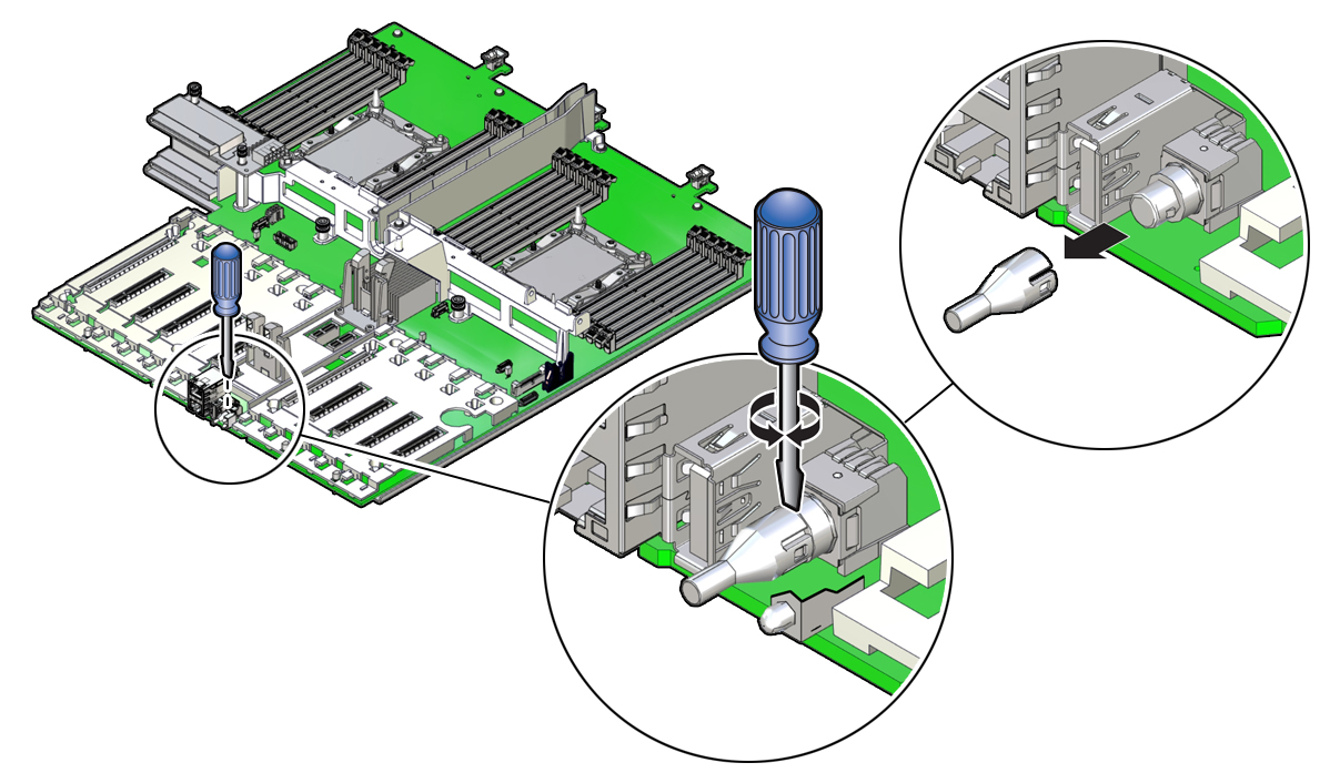

        image:Picture showing the location of the light pipe, and                                             the motion to remove it.
      2. Twist the tool back and forth to release the light pipe from the housing.
      3. Pull the light pipe away from the housing.
