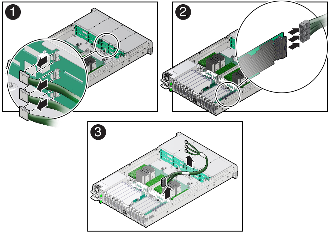

  2. Disconnect the SAS cables from the disk backplane [1].
    Press the green button on the connector while gently pulling the connector from the disk backplane.
    image:Figure showing SAS drive cables being removed from the                             server.
  3. Disconnect the SAS cables from the Oracle Storage 12Gb SAS PCIe RAID HBA, Internal card in PCIe slot 11 [2].
    Press each latch, and then pull out to disengage the cable from each connector. See also Remove the Internal HBA Card and HBA Super Capacitor.
  4. Remove the SAS cables from the server [3].
    Carefully remove the SAS cable bundles from the server. Be careful not to snag the cables on the server components.
