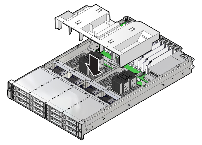

  2. Install the air baffle by placing it into the server and lowering it to its inserted position.
    image:Figure showing the air baffle being lowered into its inserted                             position.

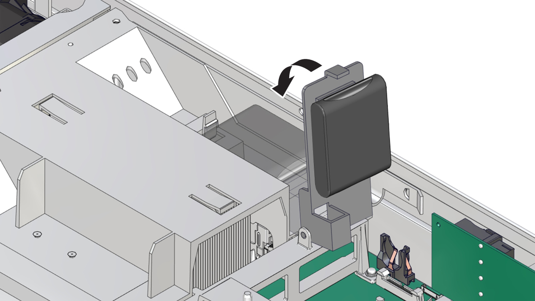

  3. Rotate the HBA super capacitor tray down and in to its closed position.
    You hear an audible click when the tray is properly secured to the air baffle.
    image:Figure showing the HBA super capacitor tray being rotated in to its                             closed position.
