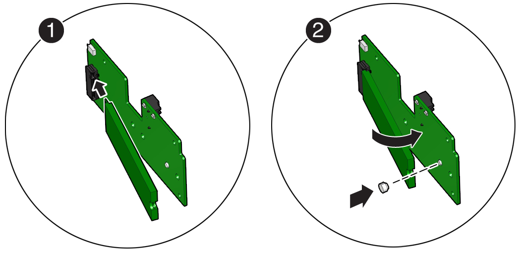

    1. Align and then insert the plastic retainer clip into the slot on the M.2 flash SSD.
    2. Hold the M. 2 flash SSD so that the end of the card containing the plastic retainer clip is approximately one-half to one inch above the riser board and the other end is adjacent to the riser SSD socket [1].
      image:Figure showing an M.2 flash SSD being installed on to a                                     riser board.
    3. Gently slide the M.2 flash SSD forward and into the connector to engage the flash SSD contacts with the riser board socket [2].
    4. Using your fingers, push down on the end of the card containing the plastic retainer clip until the M.2 flash SSD snaps into place on the riser board [2].
      You hear an audible click when the M.2 flash SSD is secured to the flash riser board.
