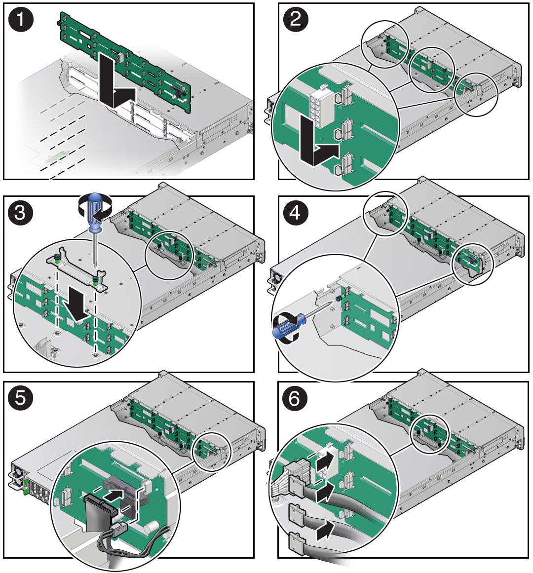

  1. Lower the disk backplane into the server, and position it to engage the standoff hooks [1 and 2].
    image:Figure showing the disk backplane being installed in the                             server.
  2. Lower the backplane bracket into the server, and using a Torx T25 screwdriver, tighten the spring-mounted screws to secure the bracket to the chassis [3].
  3. Using a Torx T15 screwdriver, tighten the right-side and left-side spring-mounted screws to secure the disk backplane to the chassis [4].
  4. Reconnect the cables to the disk backplane.
    1. Reconnect the auxiliary signal cable to the disk backplane [5].
    2. Reconnect the temperature signal cable to the disk backplane [5].
    3. Reconnect the three SAS cables to the disk backplane [6].
      To ensure proper SAS cable connections, see Install SAS Storage Drive Cables.
    4. Reconnect the power cable to the disk backplane [6].
