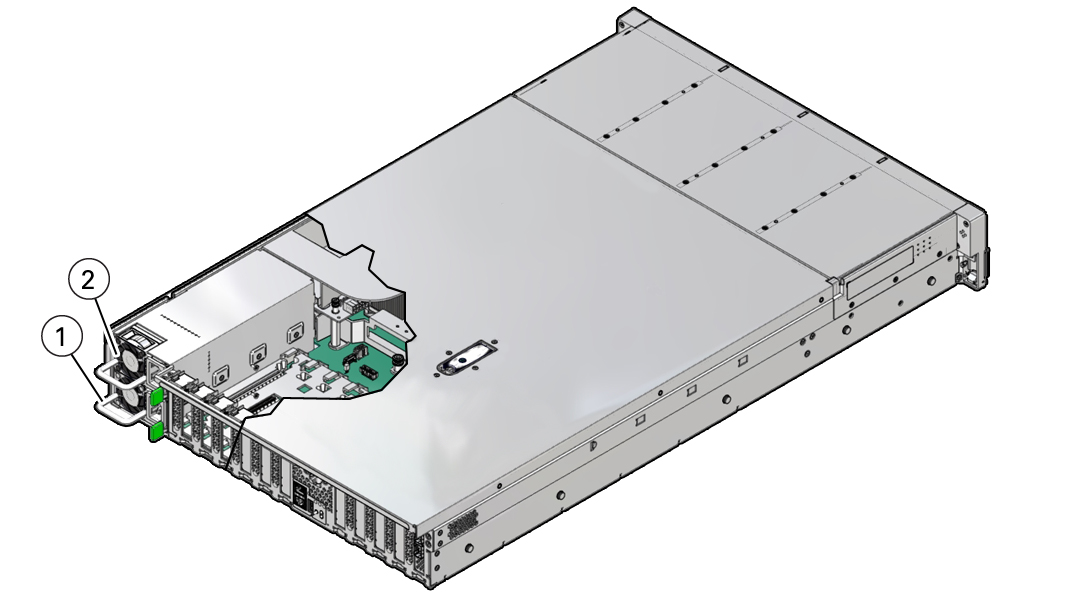

  2. Identify which power supply requires replacement.
    image:Figure identifying PS0, PS1, and their latches.
    Callout
    Description
    1
    Power supply 0
    2
    Power supply 1
    A lit amber Fault-Service Required LED on a power supply indicates that a failure was detected. You also can use the Oracle ILOM show faulty command at the Oracle ILOM command-line prompt (->) to identify a power supply failure.
    Alternatively, to list all known faults in the server, log in to Oracle Solaris and issue the fmadm faulty command, or log in to the Oracle ILOM service processor from the Oracle ILOM Fault Management Shell and issue the fmadm faulty command. For more information about how to use the Oracle ILOM Fault Management Shell and supported commands, refer to the Oracle ILOM User's Guide for System Monitoring and Diagnostics Firmware Release 4.0.x in the Oracle Integrated Lights Out Manager (ILOM) 4.0 Documentation Library at http://www.oracle.com/goto/ilom/docs.
    Note -  The fans of a failed power supply might still be spinning when the system is powered on. The fans stop spinning when you disconnect the power cords.
