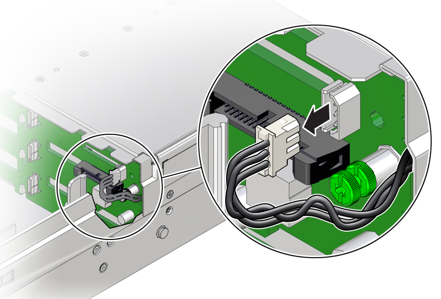

  3. Disconnect the temperature sensor cable from the disk backplane.
    image:Figure showing the temperature sensor cable being disconnected from                             the disk backplane.

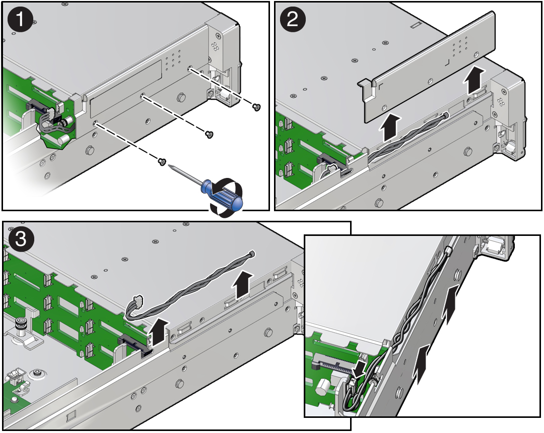

  4. Remove the three No. 2 Phillips screws that secure the FIM cable and Temp Sensor Access cover to the chassis [1].
    image:Figure showing the temperature sensor being removed from the                             chassis.
  5. Lift up and remove the FIM cable and Temp Sensor Access cover from the FIM cable and Temp Sensor Access cover slot [2].
  6. Set aside the FIM cable and Temp Sensor Access cover.
  7. Remove the temperature sensor by carefully pulling the sensor cable rearward and through the cable trough along the left side of the chassis. Then lift the temperature sensor from the chassis [3].
