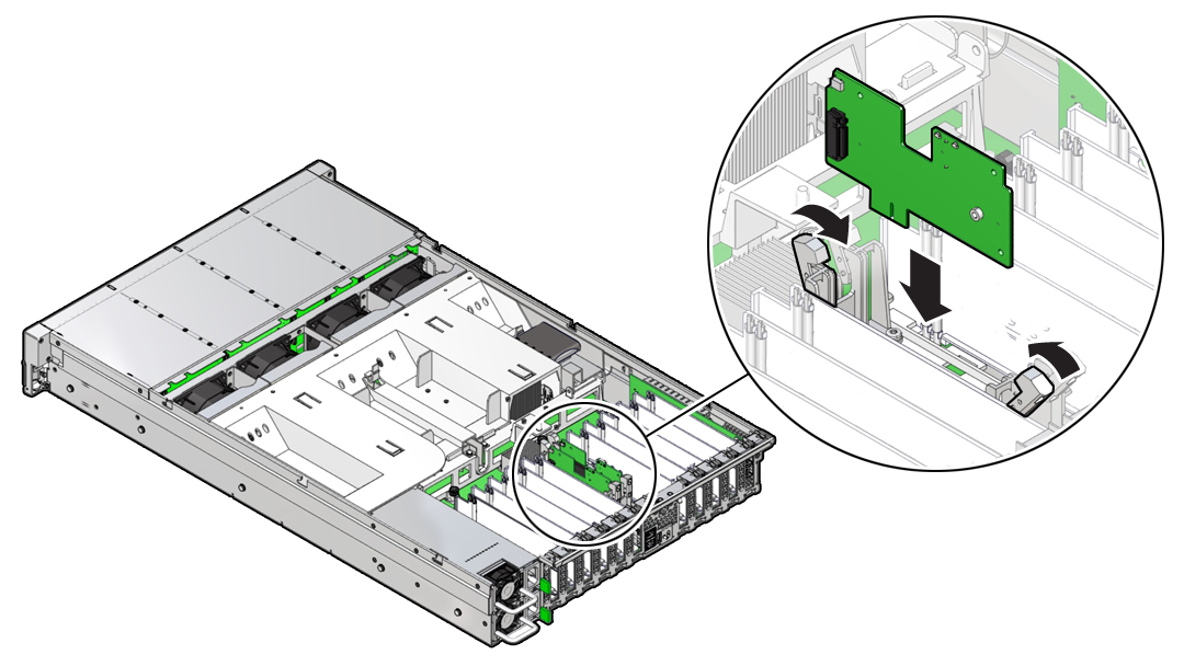

  2. Install the flash riser board.
    1. Ensure that the riser board socket levers are in the open position.
    2. Align the notch in the replacement riser board with the connector key in the connector socket.
      The notch ensures that the riser board is oriented correctly.
    3. Push the riser board into the connector socket until the riser board is securely seated in the socket.
      Caution
      Caution  -  If the riser board does not easily seat into the connector socket, verify that the notch in the riser board is aligned with the connector key in the connector socket. If the notch is not aligned, damage to the riser board might occur.
      image:Figure showing an M.2 flash riser board being installed                                     into the server.
    4. Rotate the riser board socket levers inward until the riser board is secured in place.
