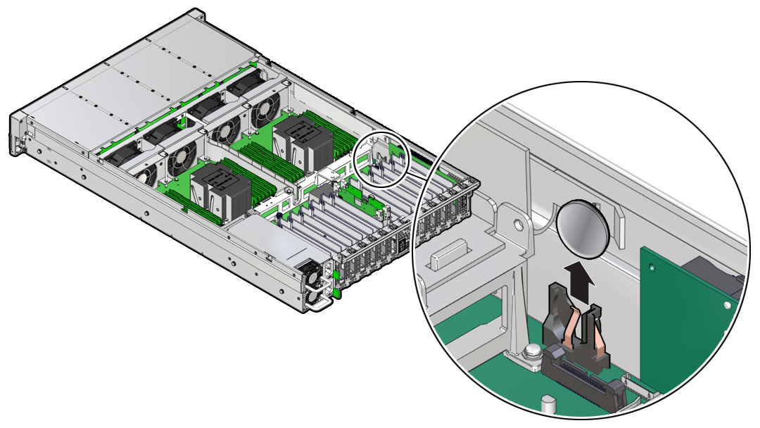

  2. To dislodge the battery from its retainer, use your finger to gently push the top edge of the battery away from the retainer.
    Note -  To gain access to the battery, you might need to disconnect and move aside the auxiliary signal cable to the disk backplane and the SAS cables to the Internal HBA. For more information, see Servicing the Disk Backplane and Servicing SAS Cables.
    image:Figure showing how to remove the system battery.
  3. Lift the battery up and out of its retainer.
