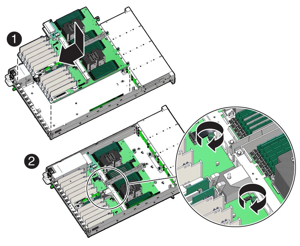

  2. Carefully lift and place the motherboard assembly into the chassis [1].
    While holding the motherboard mid-wall, tilt the motherboard to the right side to fit it under the power supply assembly, then level the motherboard and place it into the server chassis. Slide the motherboard to the back of the server to engage the raised standoffs.
    Caution
    Caution  -  Be careful not to damage the rear Locate Button/LED when placing the motherboard into the chassis.
    image:Figure showing the motherboard assembly being installed in the                             server.
  3. Using a Torx T25 screwdriver, tighten the two captive screws to secure the motherboard mid-wall to the chassis [2].

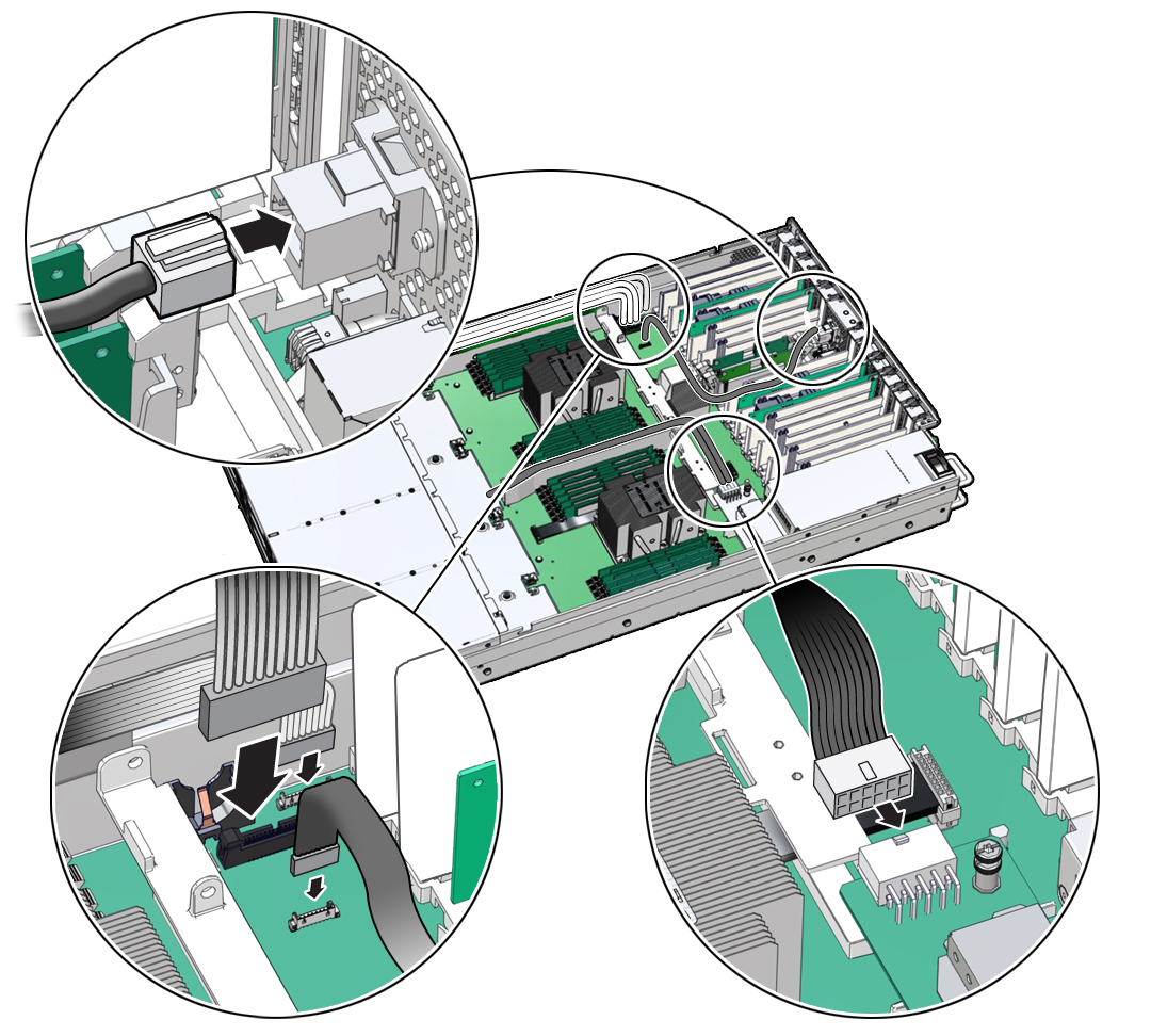

  4. Reconnect the following cables to the motherboard:
    image:Figure showing cables being connected to the motherboard                             assembly.
