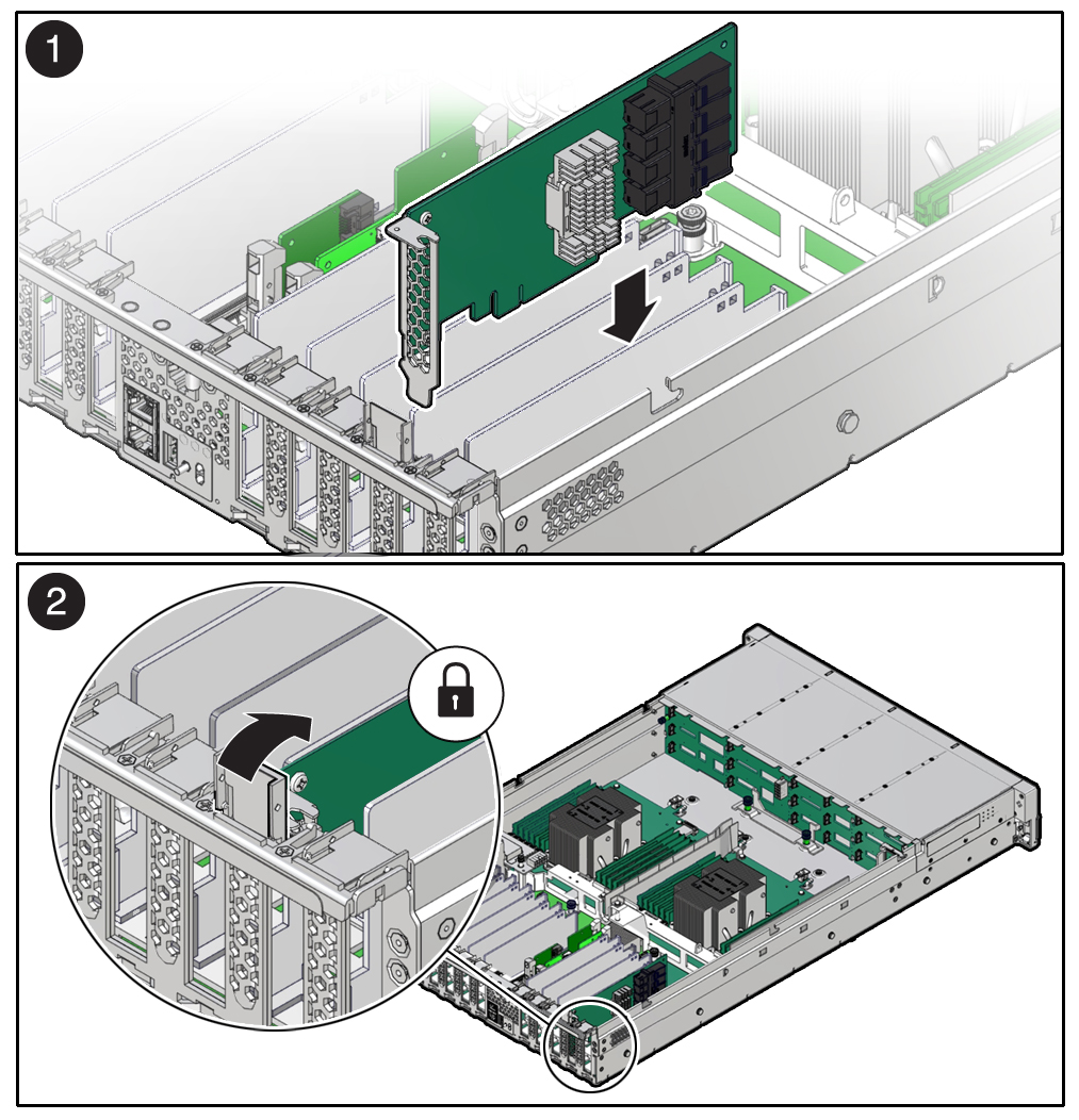

  4. Insert the PCIe card into the correct slot [1], and rotate the PCIe locking mechanism downward to secure the PCIe card in place [2].
    You hear an audible click when the PCIe card is secured into the slot.
    image:Figure showing a PCIe card being installed into the                             server.
