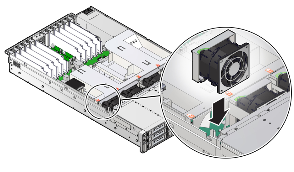

  1. Remove the replacement fan module from its packaging, and place it on an antistatic mat.
  2. With the server top cover removed, install the replacement fan module into the server.
    The fan modules are keyed to ensure that they are installed in the correct orientation.
    image:Figure showing how to install a fan module.
  3. Press down on the fan module to fully seat the fan module.
