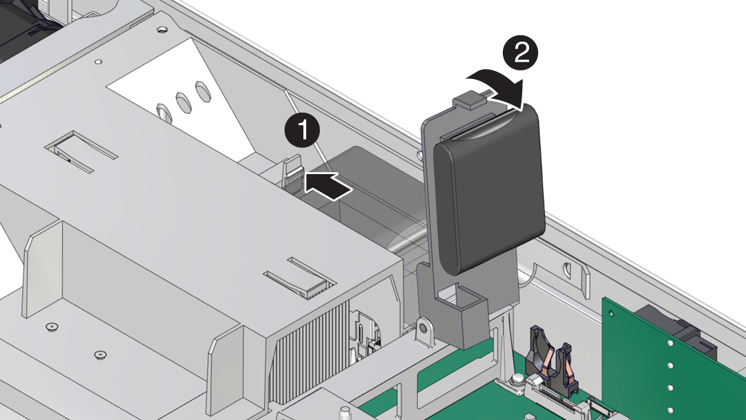

  2. Release the latch for the host bus adapter (HBA) super capacitor tray and rotate the tray [1] in to the upright position [2].
    image:Figure showing the HBA super capacitor tray being rotated in to the                             upright position.

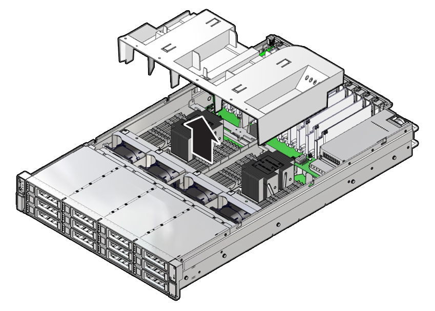

  3. Remove the air baffle by lifting the baffle up and out of the server.
    image:Figure showing the air baffle being lifted from the                             server.
