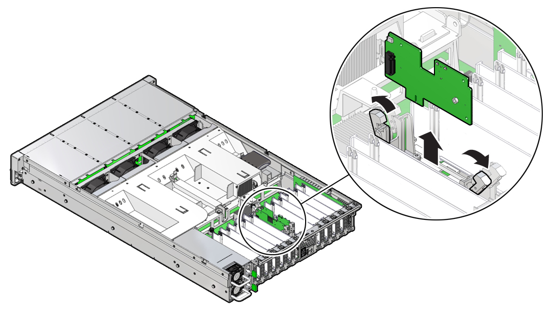

  2. To remove the flash riser board, do the following:
    1. Rotate both riser board socket levers outward as far as they go.
      Note -  The green power LED on the riser board is extinguished when you open the socket levers.
    2. Carefully lift the riser board straight up to remove it from the socket.
      Place the riser board on an antistatic mat. If required, perform the procedures for removing the M.2 flash SSD from the flash riser board. For instructions, see Identify and Remove an M.2 Flash SSD.
      image:Figure showing a flash riser board being removed from the                                     server.
