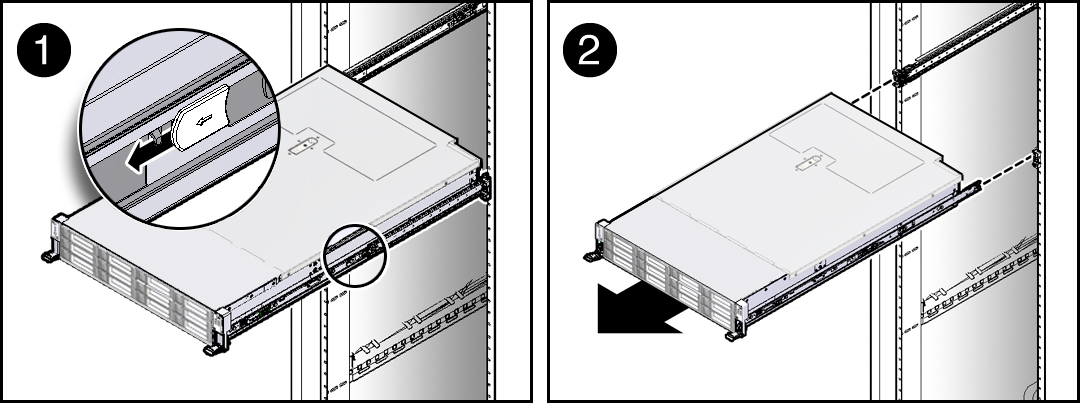

  4. From the front of the server, pull the green slide-rail release tabs toward the front of the server, and pull the server out of the rack until it is free of the rack rails [1 and 2].
    A slide-rail release tab is located on each slide-rail.
