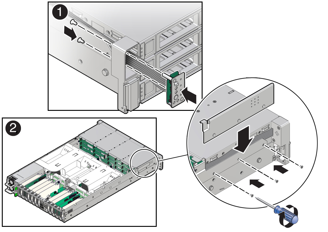

  1. Install the front LED indicator module.
    1. Push the LED indicator module and cable through the LED housing on the server front panel [1].
      image:Figure showing the installation of the front LED indicator                                     module.
    2. Install the LED indicator module cable by carefully pulling the cable through the cable trough along the left side of the chassis.
      Note -  To ease installation of the LED indicator module cable, slightly lift the SAS cable bundles from the cable trough along the left side of the chassis.
      Note -  Cable part number 7315469 is required for the LED indicator module.
    3. Insert and tighten the two No. 2 Phillips screws to secure the LED indicator module to the server front panel [1].
    4. Install the FIM cable and Temp Sensor Access cover to the chassis by inserting it into the FIM cable and Temp Sensor Access cover slot [2].
      Caution
      Caution  -  Be careful not to damage the temperature sensor when installing the FIM cable and Temp Sensor Access cover to the chassis.
    5. Install the three No. 2 Phillips screws to secure the FIM cable and Temp Sensor Access cover to the chassis [2].

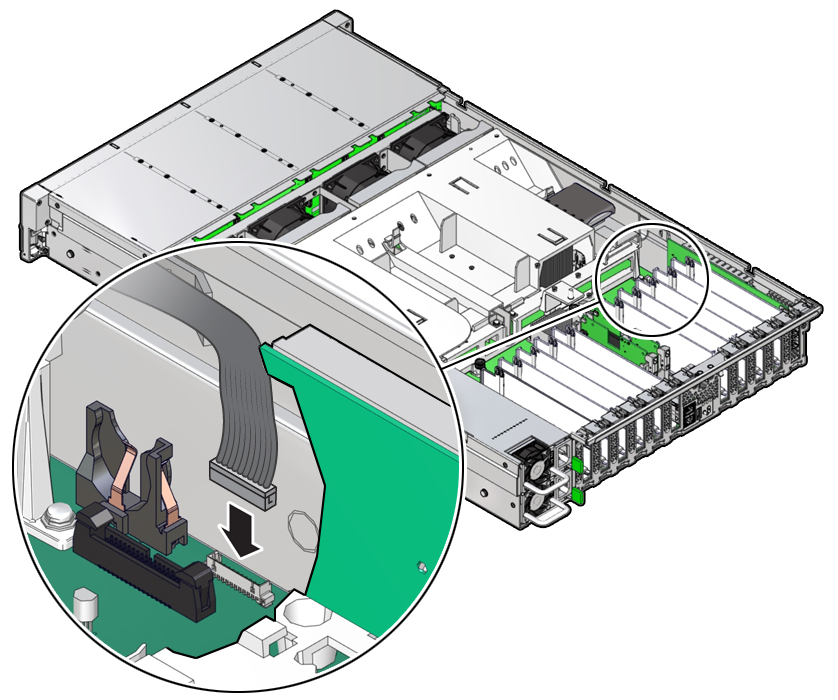

  2. Reconnect the LED indicator module cable to the motherboard.
    Note -  On the HC server, you might need to disconnect the SAS cable connections from the Oracle Storage 12 Gb SAS PCIe RAID HBA, Internal card in PCIe slot 11 to access the LED indicator module motherboard cable connection. See Servicing SAS Cables.
    image:Figure showing the LED indicator module cable being reconnected to                             the motherboard.
