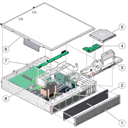

Top Cover, Filter Tray, and DVD Tray Locations
image:This figure shows the illustrated parts breakdown for the server.
No.
Name
Service Link
1
Filter tray
2
Air filter
3
DVD bracket
4
LED board
5
DVD drive
6
Top cover
7
Fan board
8
Air baffle
Related Information
