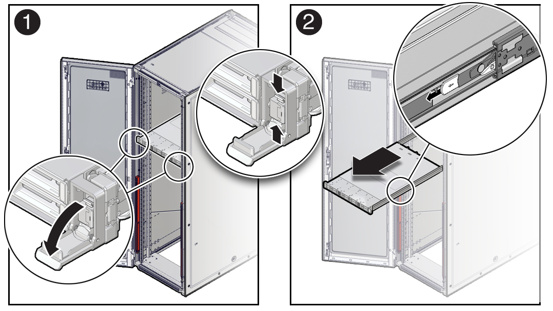

  3. From the front of the server, open and hold the left and right release latch covers in the open position [1].
    When in an open position, the release latch covers engage the slide-rail release latches [1].
    Caution
    Caution  -  Deploy any rack anti-tilt mechanism before releasing the slide-rail release latches.
    image:Figure showing how to extend the server to the maintenance                                 position.
  4. While the release latch covers are in the open position, slowly pull the server forward until the slide-rails latch into a locked position [2].
    The server is now in the extended maintenance position.
