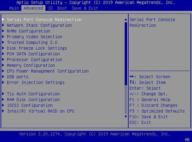

BIOS Advanced Menu Selections
This section includes a screen of the BIOS Advanced Menu. The options that are
available from the Advanced Menu are described in the table that follows. Options in the
table that are marked as “(R/O)” are read-only information and cannot be
changed.
The following sections describe the BIOS Advanced menu options.
