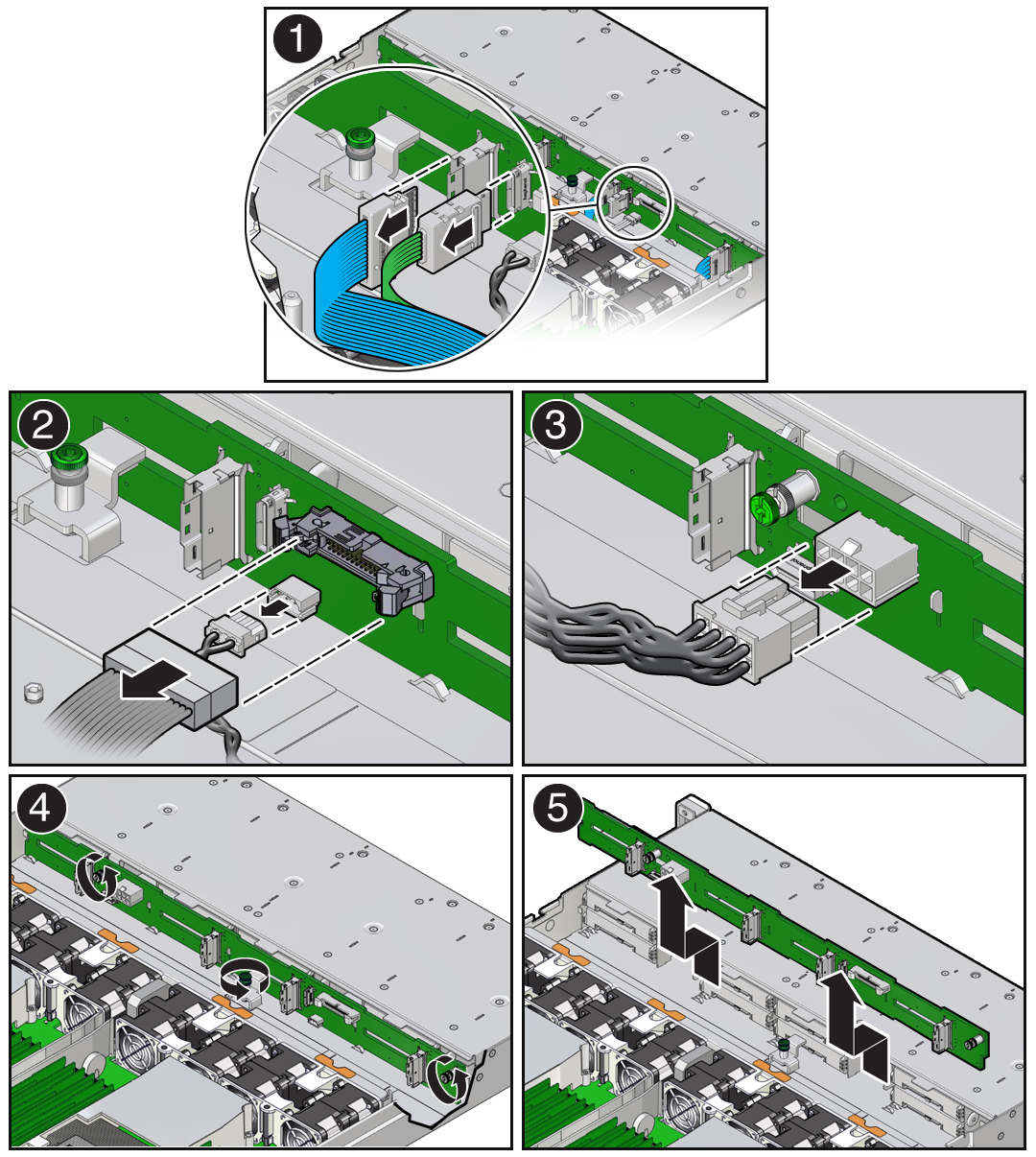

  3. Disconnect the SAS cables from the disk backplane [1].
    image:Figure showing how to remove the disk backplane from the                             server.
  4. Disconnect the disk backplane data cable and the temperature sensor cable from the disk backplane [2].
  5. Disconnect the disk backplane power cable from the disk backplane [3].
  6. Using a Torx T15 screwdriver, loosen the three captive screws that secure the disk backplane to the chassis [4].
  7. Lift the backplane up and tilt it toward the rear of the server to free it from the hooks and right-side metal bracket, and lift it out of the server [5].
  8. Place the disk backplane on an antistatic mat.
