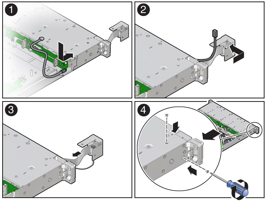

  1. Install the temperature sensor by carefully inserting the sensor-end of the cable through the rear opening directly under the left side of the disk backplane. Then push/pull the sensor cable through the left-front chassis sidewall [1].
    image:Figure showing the temperature sensor being installed into the                             chassis.
  2. Install the temperature sensor into the plastic housing by inserting the cable through the slit in the housing. Then ensure that the temperature sensor is properly seated into the housing [2, 3].
  3. Carefully insert the FIM assembly into the front panel of the server chassis [3].
  4. Install and tighten the two Phillips screws to secure the FIM assembly to the server chassis [4].

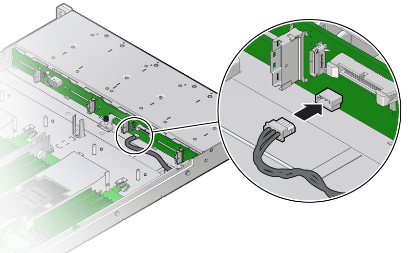

  5. Reconnect the temperature sensor cable to the disk backplane.
