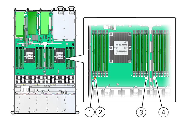

  2. Identify the location of the failed processor by pressing the Fault Remind button on the motherboard.
    Note -  When you press the Fault Remind button, an LED located next to the Fault Remind button lights green, indicates that there is sufficient voltage in the fault remind circuit to light any fault LEDs that were lit due to a failure. If this LED fails to light when you press the Fault Remind button, it is likely that the capacitor powering the fault remind circuit lost its charge. This can happen if you press the Fault Remind button for a long time with fault LEDs lit, or if power was removed from the server for more than 15 minutes.
    The processor fault LED for the failed processor lights. The processor fault LEDs are located next to the processors. See Motherboard Status Indicators.
    • If the processor fault LED is off, the processor is operating properly.
    • If the processor fault LED is on (amber), the processor has failed and must be replaced.
    image:Figure showing how to identify a failed processor by pressing the                             Fault Remind button.
    Callout
    Description
    1
    Fault Remind button
    2
    Fault Remind LED
    3
    Processor 0 fault LED
    4
    Processor 1 fault LED

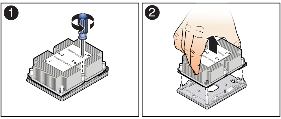

  3. Using a Torx T30 screwdriver, loosen the four captive nuts that secure the processor-heatsink module to the socket: fully loosen nut 4, then 3, then 2, then 1 [1].
    image:Figure showing processor-heatsink module being removed from the                             socket.
  4. Lift the processor-heatsink module from the socket [2].
    Always hold the processor-heatsink module along the axis of the fins to prevent damage.

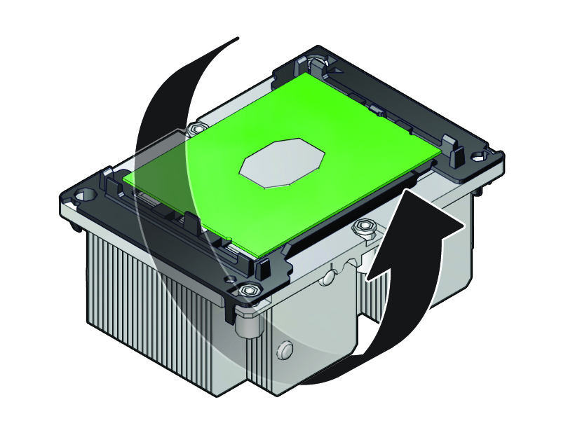

  5. Separate the processor from the heatsink.
    1. Flip over the processor-heatsink module, place it on a flat surface, and locate the thermal interface material (TIM) breaker slot.
      image:Figure showing the processor-heatsink module being flipped                                     over to locate the TIM breaker slot.

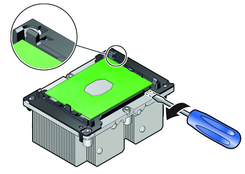

    2. While holding down the processor-heatsink module by the edges, insert a flat blade screwdriver into the TIM breaker slot.
      The blade of the screwdriver goes into the slot between the heatsink and processor carrier, not between the processor and processor carrier.
      image:Figure showing a screwdriver being used to pry the                                     processor from the heatsink.
    3. Using a rocking motion, gently pry the corner of the processor carrier away from the heatsink.

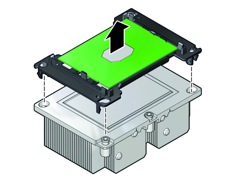

    4. Remove the processor carrier (with processor still attached) from the heatsink by prying or pinching the plastic latch tabs that attach the processor to the heatsink.
      image:Figure showing the processor carrier being detached from                                     the heatsink.
    Caution
    Caution  -  A thin layer of thermal grease separates the heatsink and the processor. This grease acts as an adhesive. Do not allow the thermal grease to contaminate the work space or other components.
